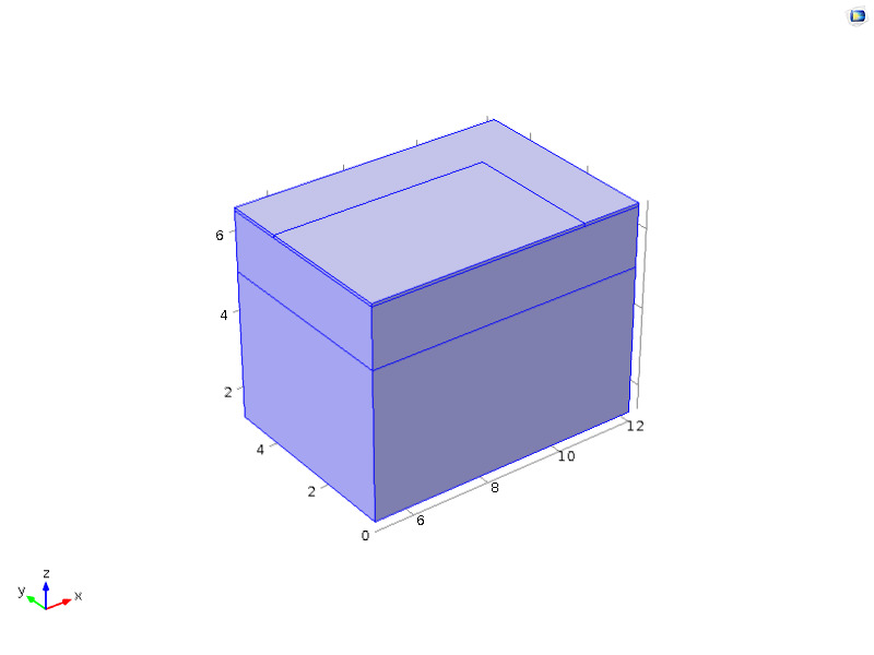

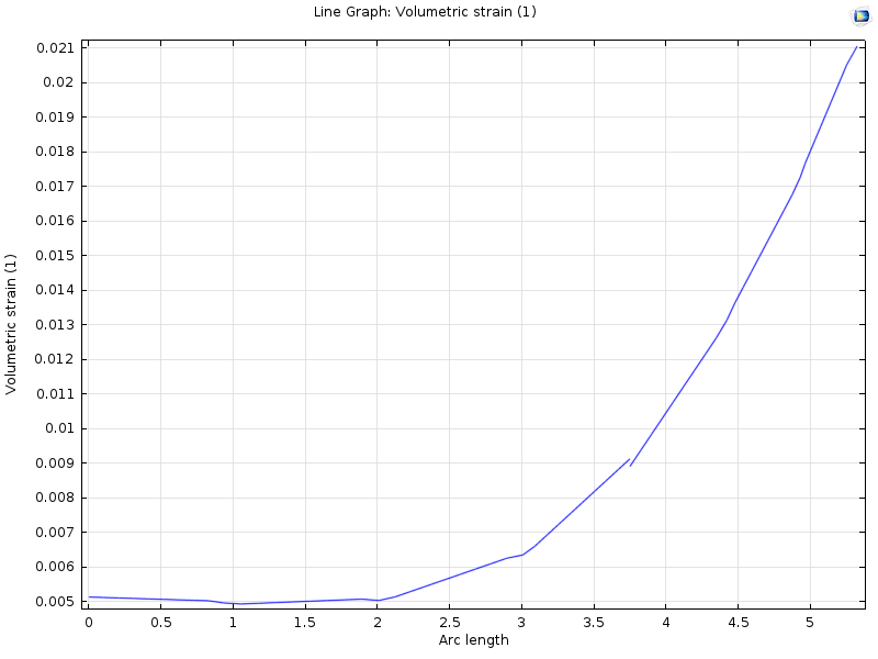

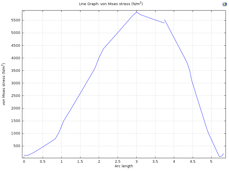

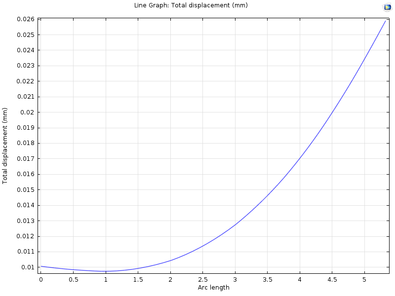

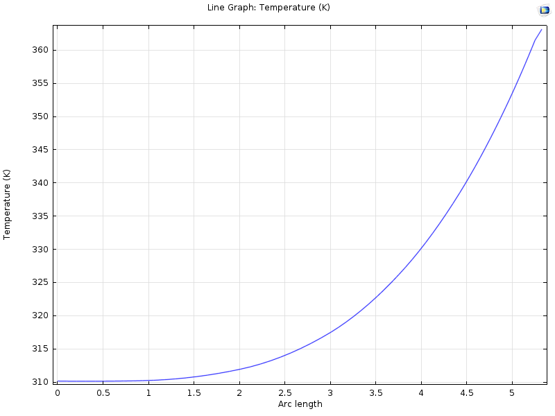

I ran a Solid Thermal Coupling Problem. The Model is shown in (Attatchment 1). There is theree solid region of different thermal properties. In Temperature (Attachment 2) and Displacement (Attachment 3) Curve it is running ok. But a discontinuity appears at stess (Attachment 5) or strain curve (Attachment 4).

This is inherent in the finite element method. The degrees of freedom are continuous. Gradients are only continous within elements, but not over element borders.
Henrik
Henrik Sönnerlind
COMSOL
Hi, This is inherent in the finite element method. The degrees of freedom are continuous. Gradients are only continous within elements, but not over element borders. Regards, Henrik
