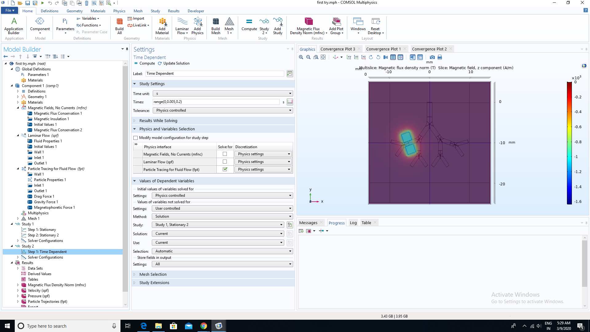

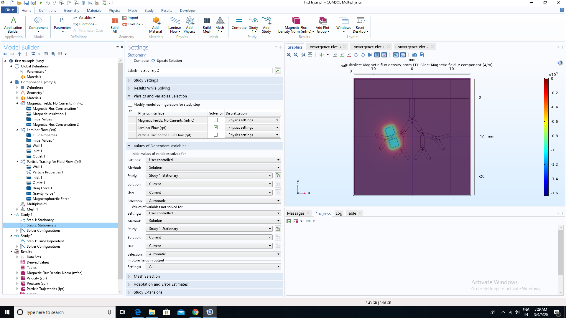

I want to simulate 3 studies a) magnetic filed (stationary) b)laminar flow (stationary) c) Particle tracing due to fluid flow (time dependent) I divided it into two studies Study 1- Step 1 Magnetic filed Step 2-Laminar flow Study 2- Step 1 - Particle tracing
My question is how can I pass results of my magnetic field study in study 1 step1 to laminar flow study(step2)? Like what to put in 'Values of dependent variables column'?
After this how to give the solution of this study for time dependent (study 2)?
