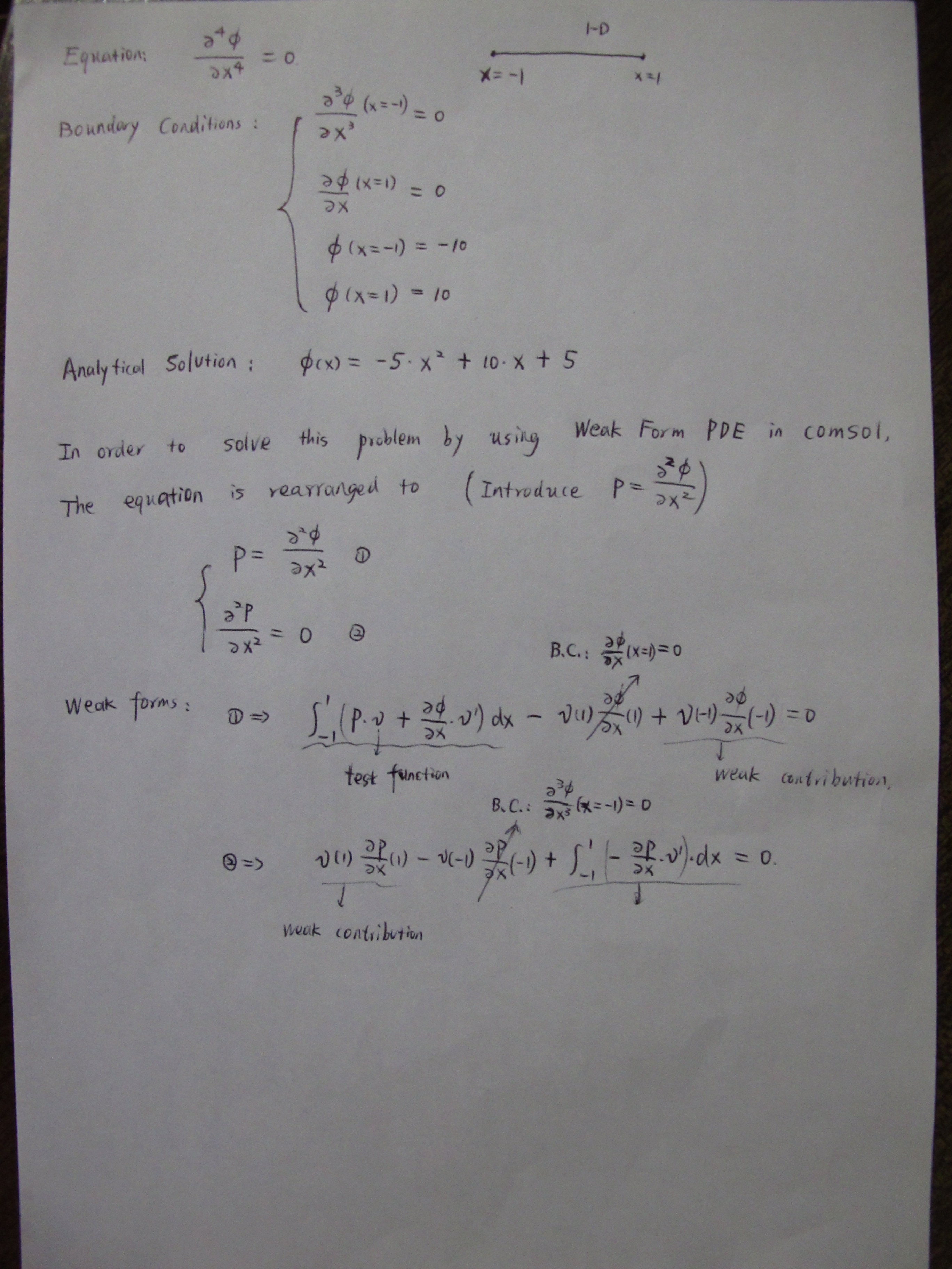

Hello:
I'm new to the Weak Form Modeling in Comsol and I have some questions regarding the 1-Dimensional 4th oder PDE modeling using Weak Form. The equation is shown below: (a clear view of this problem is in .JPG file and .mph file)
d^4(phi)/dx^4 = 0, within domain: -1 <= x <= 1
Boundary conditions: d^3(phi)/dx^3 = 0 at x=-1
d(phi)/dx = 0 at x=1
phi = -10 at x=-1
phi = 10 at x=1
In order to solve the 4th order PDE in Comsol, I introduce a new variable P that P = d^2(phi)/dx^2. Then the equation becomes:
P = d^2(phi)/dx^2
d^2(P)/dx^2 = 0
I transform these two equations into weak forms and I get two weak form equations:
Integral(weak_expression_1) + weak_contribution_1 = 0
Integral(weak_expression_2) + weak_contribution_2 = 0
In Comsol, I can enter weak_expression_1 and weak_expression_2 in two boxes in Weak Form PDE 1 under PDE(w) module. Then I add weak_contribution_1 and weak_contribution_2 in Weak Contribution 1 and 2 under PDE(w) module. But when I solve this problem, the Comsol's result doesn't match the analytical solution (in the .JPG file).
My question is, when I enter the weak_contribution_1 and weak_contribution_2 in Weak Contribution under PDE(w) module, which equations does Comsol add them to, since there is only one box in the Weak Contribution (I'm expecting two boxes).
Many thanks in advance for any suggestions.
