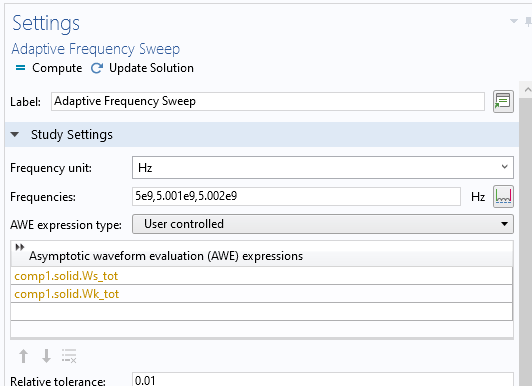

You can add an Empty Study, and then add Study Steps -> Frequency Domain -> Adaptive Frequency Sweep.
Set AWE Expression Type to User Controlled, and add some suitable global expressions for error estimation, for example the total strain energy and total kinetic energy, as in the attached screenshot.
You may also have to adjust the tolerance level. In particular, the absolute tolerance, which you will find in the AWE Solver node further down in the solver sequence. Alternatively, you can scale the error estimation expressions so that they evalaute to something of order 1.

You can add an **Empty Study**, and then add **Study Steps** -> **Frequency Domain** -> **Adaptive Frequency Sweep**.
Set **AWE Expression Type** to **User Controlled**, and add some suitable global expressions for error estimation, for example the total strain energy and total kinetic energy, as in the attached screenshot.
You may also have to adjust the tolerance level. In particular, the absolute tolerance, which you will find in the **AWE Solver** node further down in the solver sequence. Alternatively, you can scale the error estimation expressions so that they evalaute to something of order 1.

I've tried your recommendation and it seems to work. Thanks again!
