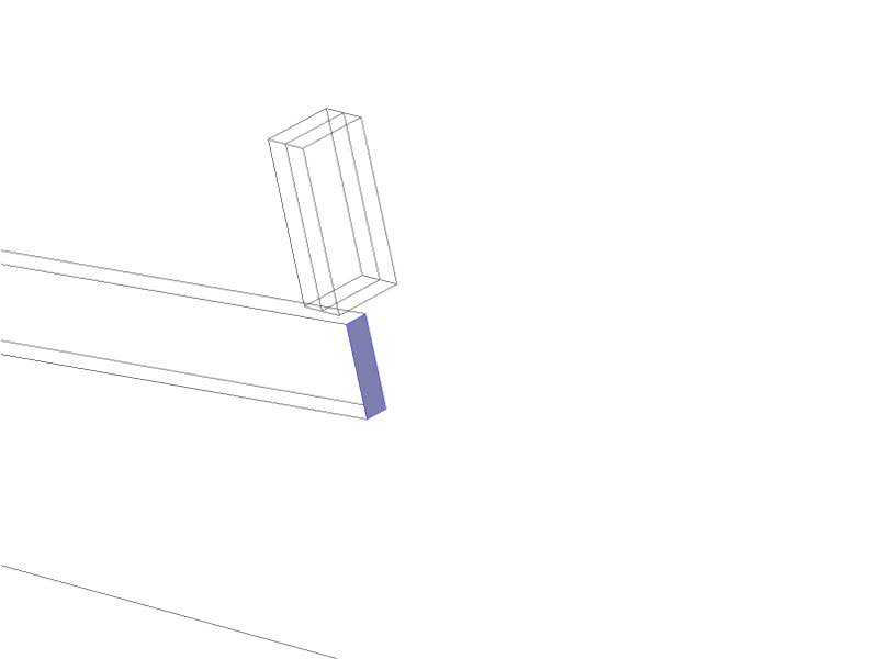

2012年3月3日 GMT+8 12:13
hi,
I've ran some test on both conditions (setting t=0 to see if it encounters problem, and also with the offset for z). The model didn't encounter problems for the first case probably because exp(0) is a valid number, whereas having z=0 would mean a division by zero (as you mentioned before).
thus, I redefined the z as such:
Name: DH--------> Expression: if(z==0,0.00000001,z)[m]
so that if z=0, it would take 0.00000001m as the first value. I hope I got the expression and the "if" operator right...
Another question came into mind. Since for my geometry, the bottom wall of the duct lies at z=0, once i offset the z up away from the bottom boundary, will the wall function still apply right after the bottom boundary at the start of the duct?
Picture description:
The highlighted rectangle is the applied inlet where my previously defined U_profile is placed. The bottom line of the highlighted boundary is z=0.
Thanks for all your help in this.
