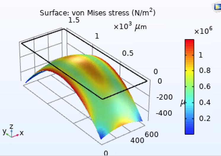

I am trying to simulate using swelling (or stress or strain, whatever works) to create curving in a thin-film of a polymer (SU8). I created a simple thin rectangle and made the hydroscopic swelling coefficient proportional to z. I put one point in the middle of the bottom face and made that the point constraint for the structure.
In theory, the film should fold into a cylinder like in this research paper in Figure 3a, because of the stress gradient in the z direction: https://www.nature.com/articles/ncomms1531 . However, it only gets to the point in the image attached here (with the deformation scaled by 10), before getting a non-convergience error. It does not complete the curve into a cylinder. Would it be possible to model the whole curving using COMSOL, and if so, do you have any advice for how I can model this correctly? My COMSOL file is also attached here.
