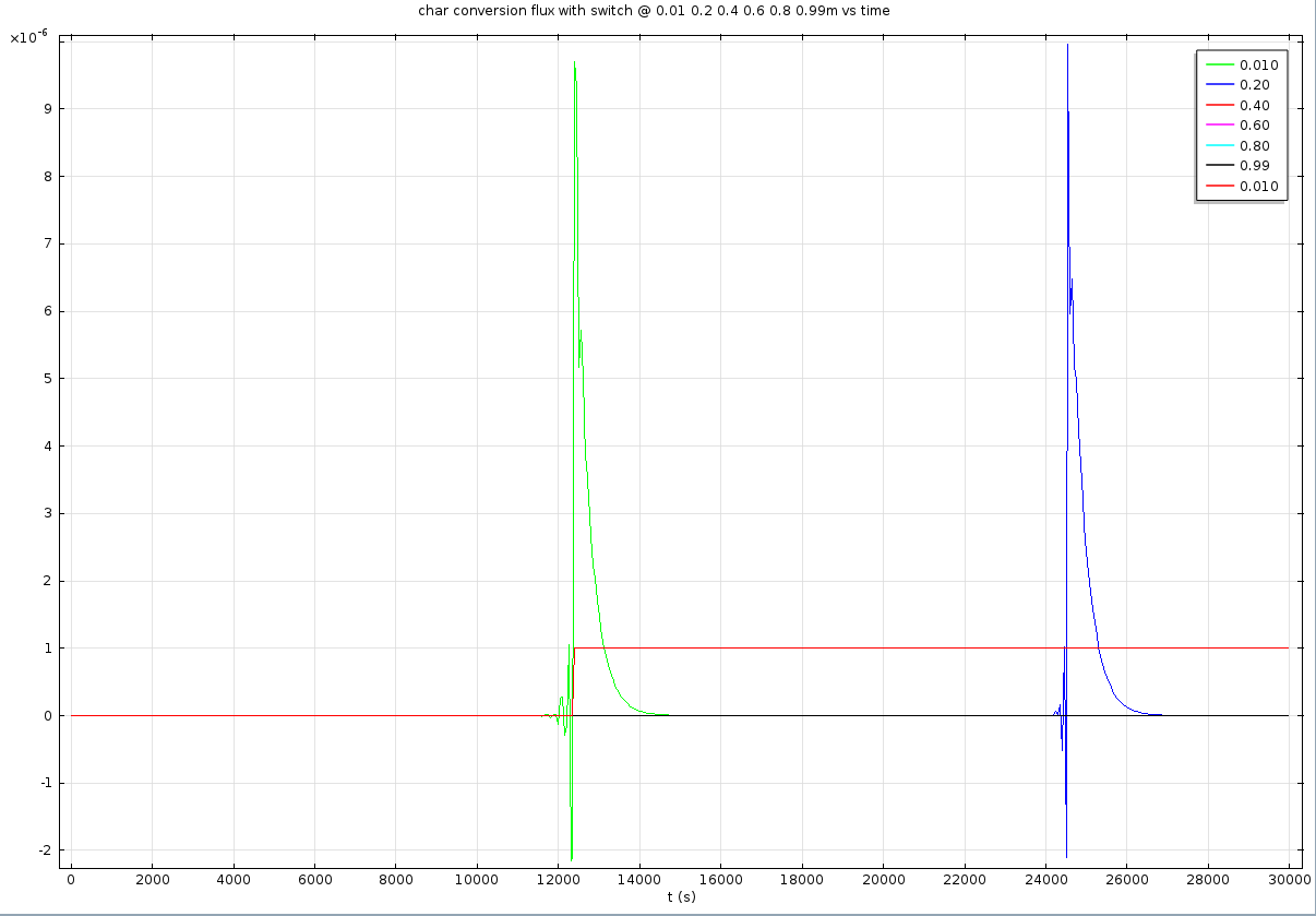

I am trying to model char combustion, for which I use a PDE function in the form like this:
dm_char/dt = -P_O2*k_eff*da_comb, in which P_O2 is the partial oxygen pressure, k_eff a rate function dependent on the amount of char left, a kinetic expression and a diffusive expression and da_comb is a switch defined as:
if(m_VOL_l_kg<0.02*Volatiles_init_wtkg_zone,1,0)
In every element there is water, volatiles and char and I want the char combustion only to start when the amount of volatiles is less then 2% left. So I keep the right hand side of the PDE zero until the condition is met. So when m_VOL<2%, the PDE activates and is dependent on the mentioned variables. This seems to work. The problem is that I want to model the energy that is released by this reaction and that does not work. It doesn't converge.
I think the problem is an instability because of the switching on of the PDE. Please view the attached pictures.

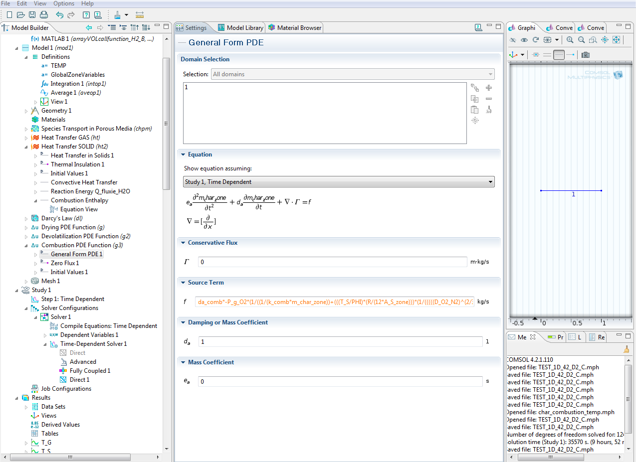

In the pictures you will see the char conversion flux (kg/s) vs time for certain x positions in the reactor. (It is a porous bed of wood particles 1 m long through which hot air flows). The red line is the da_comb switch (scaled). The instability (green) can be clearly seen. I also included an overview picture of the PDE, maybe it is useful.
The gradient is quite steep, but more elements and smaller timesteps have not worked. Any tips, pointers, hints?
I have not included the model since it is quite large and it takes a lot of time to calculate.

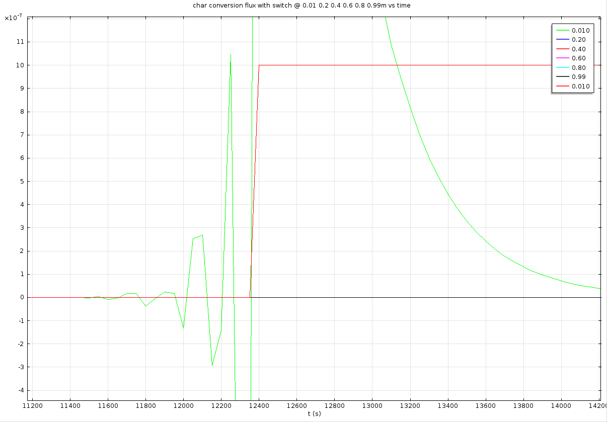

I find it interesting in the graph that the instability starts BEFORE the switch is turned on. Why is that?

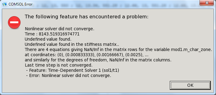

I included 2 more pictures. The first shows the error that I get when include the energy of combustion. I don't know why it says that it has found an undefined value in the stiffness matrix, but it just won't converge.
The second picture shows the amount of char left in a certain element. The amount decreases nicely as one would expect, but at the top small instabilities can be seen. These have the same origin as the instabilities in the flux plot, but where they come from...?

I am now sure that the oscillations happen because of the actual switching. Before I was thinking it could have been the combustion expression, but now I am sure that is not the problem.

12) used a smoothed step function to replace the switch, but this just makes the oscillations nice and round, but does not remove them.
