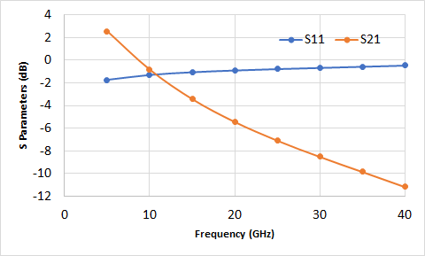

Hello! I am using COMSOL 5.5 to simulate the S11 and S21 of a coplannar waveguide, the waveguide is in the mciro scale and with some taper strucuture, I used the example "Coplanar Waveguide Bandpass Filter" (see https://www.comsol.com/model/coplanar-waveguide-bandpass-filter-12099) as a template.
I found that in my simulation, the calcualted S11 and S21 are different if I change the size (length) of the lumped ports, the lumped ports are multielement uniform type, I think there should be some problem in the model.
Doese anyone know the cause?

Since my strucutre is a little bit complex so It would be better for me to calculate the S21 with some well developed comercial software, and I noticed that COMSOL has been used to do lots of S parameters' calcualtions, and I also researched that the multielement uniform ports type is the most suitable one for my strucutre. However, I always get positive S21 (The S21 is a positive value at low frequency and gradually decreases to be negative), I have attached a results plot.
Also I read the S parameter calcualtion section in the COMSOL RF User manual (see attached PDF). The S paramter calcuation equations in the manual look strange to me, it is not the typical definition of the S parameters.

The strucutre I am simulating is a simple two ports coplannar waveguide (quite similar as the example "Coplanar Waveguide Bandpass Filter" see https://www.comsol.com/model/coplanar-waveguide-bandpass-filter-12099). RF Wave is only excited in port #1. As you can see my S21 (in dB) data it is positive at samll drive frequencies. Do you know what could be the reason?
S21 (in dB) should always be negative according to its definition.

If you are using lumped ports then the page you linked is not relevant. With lumped ports Comsol will calculate S parameters from the port voltages and currents.
I suggest either (1) simulating a length of uniform transmission line, to be sure you get the expected results (S11 = small, S21 =1) and/or (2) posting your model.
Many postings here result in no useful advice because without a model to look at it is only possible to guess.
