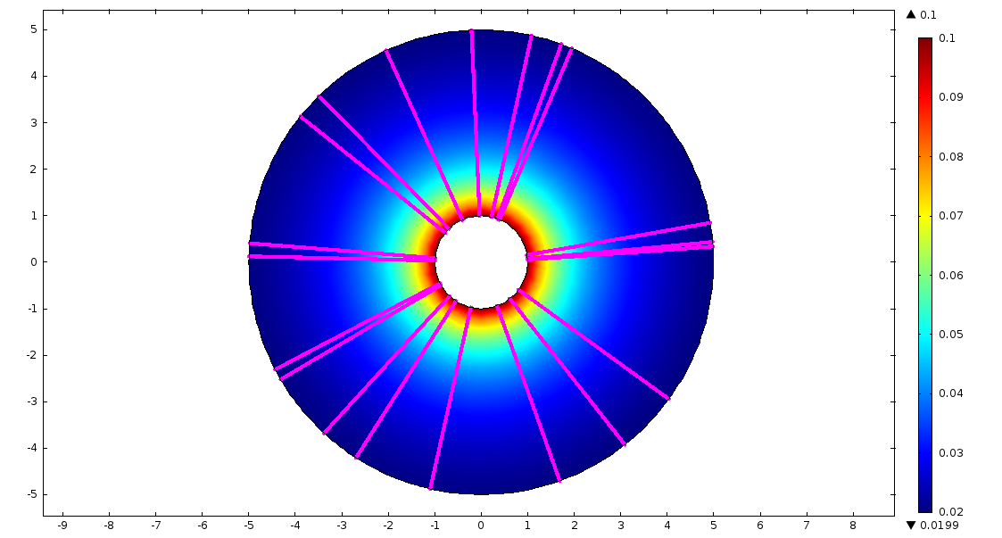

I am not sure I understand your problem, in the model you uploaded the results show both the velocity and the pressure. I even managed to plot the streamlines.
Cheers

Well, that is quite interesting, please find attached an image of velocity + streamlines. Please note that I simply opened your model and just added the streamlines. I don't know what you may need to 'turn on' in comsol.
Cheers
