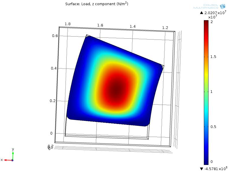

I get a pressure on a segment shaped surface using a "physic". In the real life, this surface is spinning really fast, I would like to use this pressure field (mod1.pf) to achive an axisymmetric one, and then obtain a more accurate displacement on the surface.
My idea is to use a mathematical expression to obtain an axisymmetric pressure profile taking the maximum pressure for each radius of the one I already have.
maxop1(mod1.pf) - I do not know how to input that I want the maximum for every radius,not the maximum pressure of the surface.
I will post an example if it is not clear enough.
Thanks in advance
PS. Simplified: I have an half sphere pressure distribution and I would like to obtain a half toroidal shaped one.
