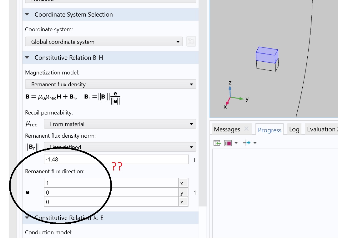

I'm modelling a simple permanent magnet with north and south pole.
The problem I'm having is using the remanent flux density, the magnetic field I've initialized has both north and south pole in the same direction, yet the solution given of the magnetic flux density is fairly concordant with what I'm getting in a hall probe.
Intuitively, this would be clearly wrong as the streamline/arrow surface are assymetrical and don't resemble the field lines that you'd typically see in a permanent magnet. However, with opposite directions, the solution does not resemble the values of the hall probe at all.
I'm hoping that someone who is more experienced in magnets would shed some light on this, and let me know if the results of my model are purely coincidental or if there is something else to it.
