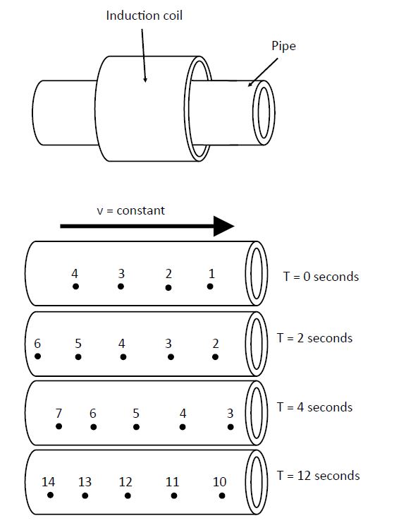

I'm trying to model the heating of a steel tube moving through an induction coil but struggling with the movement of the tube.
I want the keep the domain of the tube fixed but the material will be moving through this domain, so the mesh will be moving through the domain.
What is the best way to prescribe the velocity to for the tube?
I have attached a diagram trying to explain what I mean. The diagram shows a fixed domain with mesh nodes moving along it at given time intervals.
