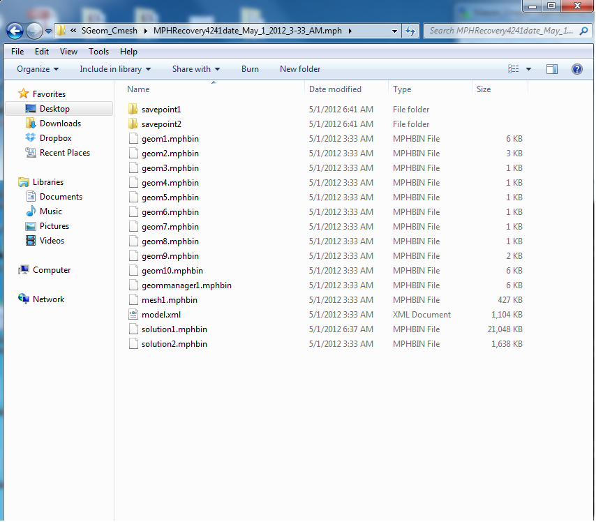

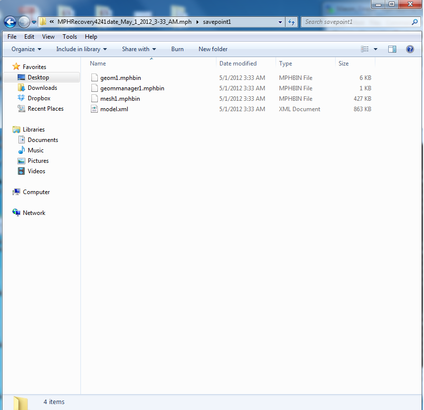

I am running Comsol 4.2 on Linux cluster. Comsol saves the recovery files in a specified directory (using option -recoverydir <path>) which saves data till last time step. However it is not in the .mph format but .mphbin files for mesh, sol1, geometry etc. All the data is there in the recovery folder but i do not know how to extract it into usable form.
Can we extract the full .mph model from these files? Please share your experience, thanks in advance. I am attaching the snapshot of how the recovery folder looks like and what it contains with this email.
I have tried contacting comsol support also but no reponse so far.
