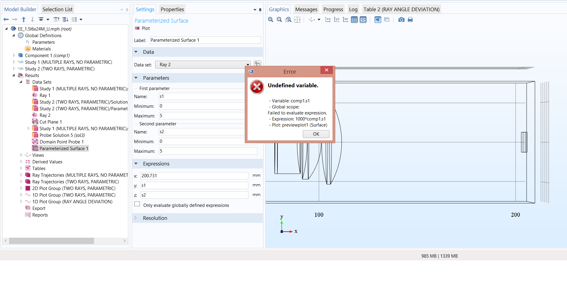

Dear Mranal,
I tried plotting Parameterized Surface as you suggested, but I have got a error (see the attachment). Could you please point out a mistake?

Dear Mranal,
