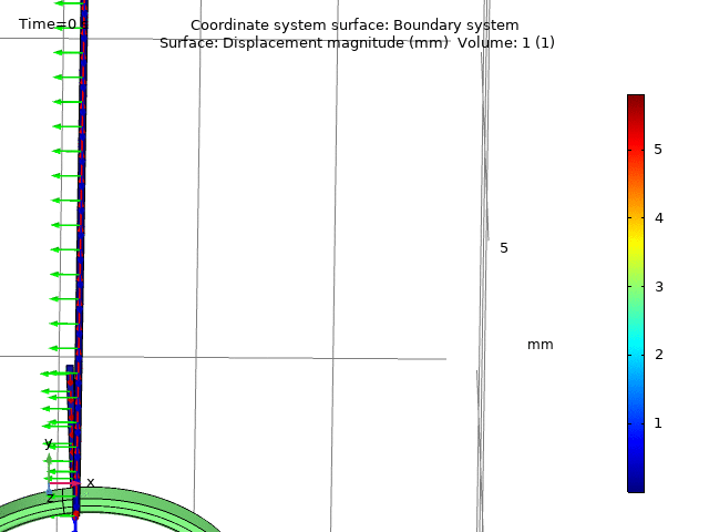

I got a time dependent study where I model a string of yarn and how it bends around a complex solid body. To implement the absence of bending stiffness of the yarn I use the membrane-physics. I works really good.
Now I want to set up a boundary load that is oriented along the surface of the yarn/membrane. If I use a boundary load on the membrane in combination with the automatically set up boundary system I can set up a force that follows the curvature of the yarn. So far so good.

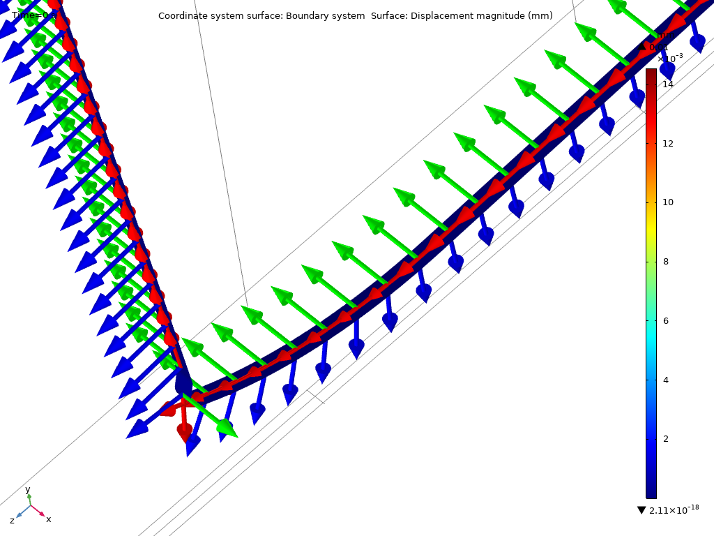

While solving the time dependent study the yarn deforms as it is bending around the counterbody. When I check the orientation of the boundary system (plot the coordinate system on the boundary of the membrane) I can see that the boundary system doesnt follow the deformation of the membrane. The boundary load is no longer oriented along the yarn by the end of the study.
Motivation behind the boundary load: the membrane-solid contact node doesn't allow sliding induced friction (there is a node for that for solid-solid contacts that came with 5.6 but not for contacts with a membrane involved). So i want to set up a boundary load that is tangential to the surface of the membrane and the magnitude should be the local contact pressure multiplicated with the friction coefficient.
How can I solve this?
(In the screenshots attached you can see how the boundary system tends to keep it's original orientation under deformation of the membrane)

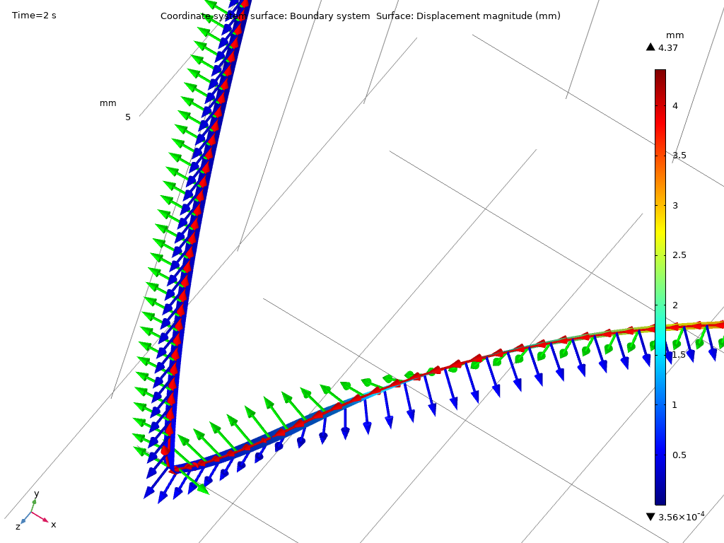

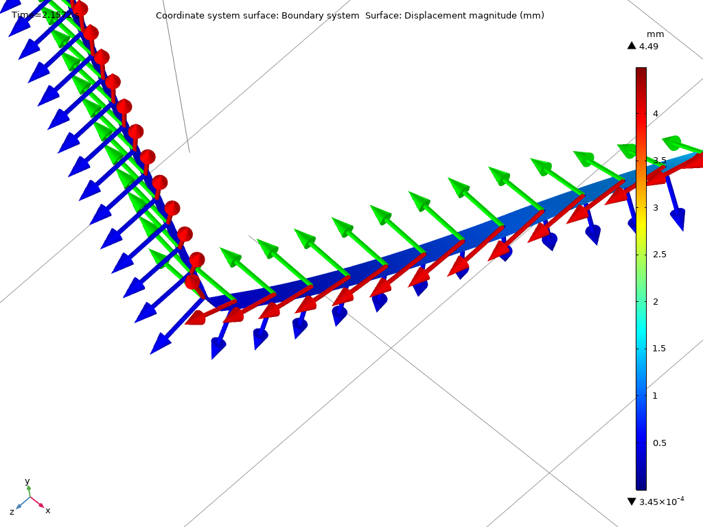

Posted: 5 years ago 2021年4月29日 GMT+8 01:28
Thanks for the reply.
The scale of the deformation is set to 1 in the plot (for the displacement of the membrane and the coordinate system).
The frame setting is on "deformed configuration" (default setting). When I change it to 'geometry' or 'reference' the boundary system definitely keeps it original orientation and does not adjust with the deformation. I tried that after you mentioned it.
With the frame setting on "deformed configuaration" the boundary system follows the deformation at first but at some point it diverges as you can see in the animated gif.
Thanks for the reply. The scale of the deformation is set to 1 in the plot (for the displacement of the membrane and the coordinate system). The frame setting is on "deformed configuration" (default setting). When I change it to 'geometry' or 'reference' the boundary system definitely keeps it original orientation and does not adjust with the deformation. I tried that after you mentioned it. With the frame setting on "deformed configuaration" the boundary system follows the deformation at first but at some point it diverges as you can see in the animated gif.
Posted: 5 years ago 2021年4月29日 GMT+8 16:07
I solved it:
In the settings of the Boundary System Node there is a dropdown menu "create first tangent direction from". It is set on "global cartesian (spartial) / (x,y,z)" by default. When i set it to "material / (X,Y,Z)" the boundary system follows the deformation perfectly.
which makes sense when I look at the pictures in the doc: https://doc.comsol.com/5.5/doc/com.comsol.help.comsol/comsol_ref_deformedmeshes.25.05.html
Thanks again for the hints!
I solved it: In the settings of the Boundary System Node there is a dropdown menu "create first tangent direction from". It is set on "global cartesian (spartial) / (x,y,z)" by default. When i set it to "material / (X,Y,Z)" the boundary system follows the deformation perfectly. which makes sense when I look at the pictures in the doc: https://doc.comsol.com/5.5/doc/com.comsol.help.comsol/comsol_ref_deformedmeshes.25.05.html Thanks again for the hints!
