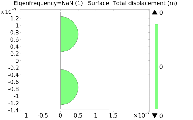

Gabriel Goncalves Machado
Posted: 4 years ago 2021年6月18日 GMT-4 05:21
Hi Edgar,
When I did it, the Eigenfrequencies return as NaN. Please see attached.
Hi Edgar, When I did it, the Eigenfrequencies return as NaN. Please see attached.
Posted: 4 years ago 2021年6月18日 GMT-4 05:58
Well, I tried it and it solved. Those pictures do not help.
