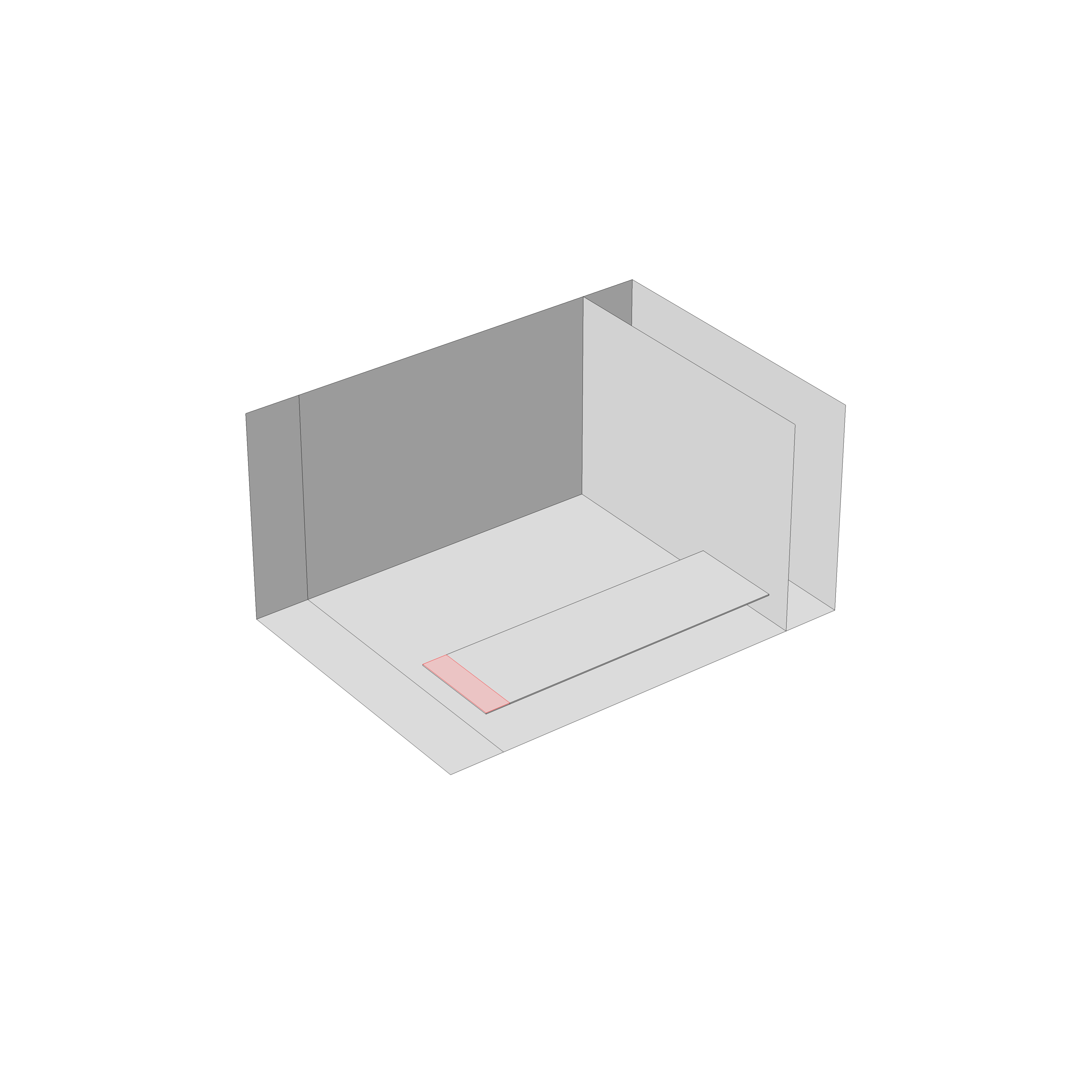

I'm trying to adept this example to a 3D problem. I have drawn a simple beam in 3D and I have the stationary simulation working fine. I apply a potential and compute the deflection. It takes 28 seconds, it's a small mesh.
To derive an estimate for the pull-in potentional I add a global equation solving (intop1(z)-zset)/zset
I pick the centre point of the beam for intop1.
In the stationary study I add the continuation parameter zset with range(1600[nm],400[nm],2400[nm])
I change the solver to fully coupled.
The simulation however does not converge, it is stuck at step 1.
Does anyone know how to solve this?

I couldn't draw it any simpler.
The mesh is 1420 elements, it's a bit like the cantilever example: www.comsol.com/showroom/gallery/444/
The air gap is actually 3500 nm
I can reduce the mesh to 520 elements but it still doesn't converge.
I can change the range to something that isn' much of a deflection: range(3000[nm],200[nm],3400[nm])
but no joy.
