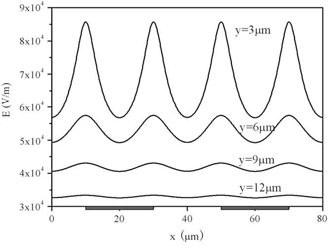

You want the gradient of the norm squared ? or something like (d(ec.normE^2,x), d(ec.normE^2,y), d(ec.normE^2,z))
I'm not sre it will work, but have a try (I'm not by my WS tonight ;), the gradient of the field are already there in COMSOL, the easiest to learn all the existing variables, is to enable the Equation view, and go through the lists of all variables

Dear Ivar,
I am working on cell separation with dielectrophoresis, AC module, and would like to use comsol for simulation. I have my design, but get stuck on entering right formula of gradient of the norm squared, would you please give me a hand on how to do this?
Thanks

Dear Ivar,
Thanks
Yibei Zhao
