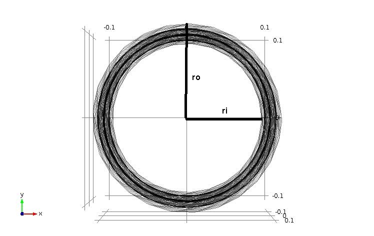

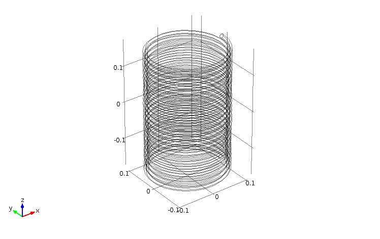

We are working on a 3D multi turn Helix model (as attached) with following parameters:
Number of turns (N) = 24
Current (I) = 50 Amps
For current density we are using the formulae:
Jx = J*y*sqrt(x^2+y^2)
Jy = J*x*sqrt(x^2+y^2)
where J = N*I/A
Here we know the values of N and I, but we are confused on what to use for the value of Area.
We believe it should be:
1. A = pi*ro^2 - pi*ri^2 (where ro = outer radius and ri= inner radius as shown in the figure Top view)
or
2. A = pi*r^2 (where r = radius of the coil)
It would be great to have your guidance.
