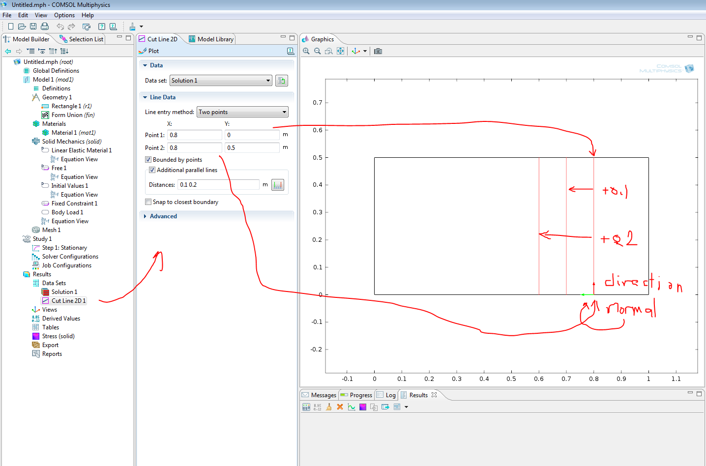

take care of the "direction" of the line you draw, or select, it might be that you should use a negative increment, it depends on the direction of the line
Hi take care of the "direction" of the line you draw, or select, it might be that you should use a negative increment, it depends on the direction of the line -- Good luck Ivar

that is normally the coordinates reference marker, you should define the line start and stop points and then add select additional lines
at least in 4.3 you get the red arrow showing the direction and the green the normal direction hence positive displacements for your additional line values
Hi that is normally the coordinates reference marker, you should define the line start and stop points and then add select additional lines at least in 4.3 you get the red arrow showing the direction and the green the normal direction hence positive displacements for your additional line values -- Good luck Ivar

Just a small comment about the first line still at y = 0. That is the original cut line that you define as
Point 1 (x = 0, y = 0)
Point 2 (x = 0.02, y = 0)
The additional parallel lines that you add do not replace the original cut line, just adds more parallel lines.
Best regards,
Magnus Ringh, COMSOL
Hi, Just a small comment about the first line still at y = 0. That is the original cut line that you define as Point 1 (x = 0, y = 0) Point 2 (x = 0.02, y = 0) The additional parallel lines that you add do not replace the original cut line, just adds more parallel lines. Best regards, Magnus Ringh, COMSOL
