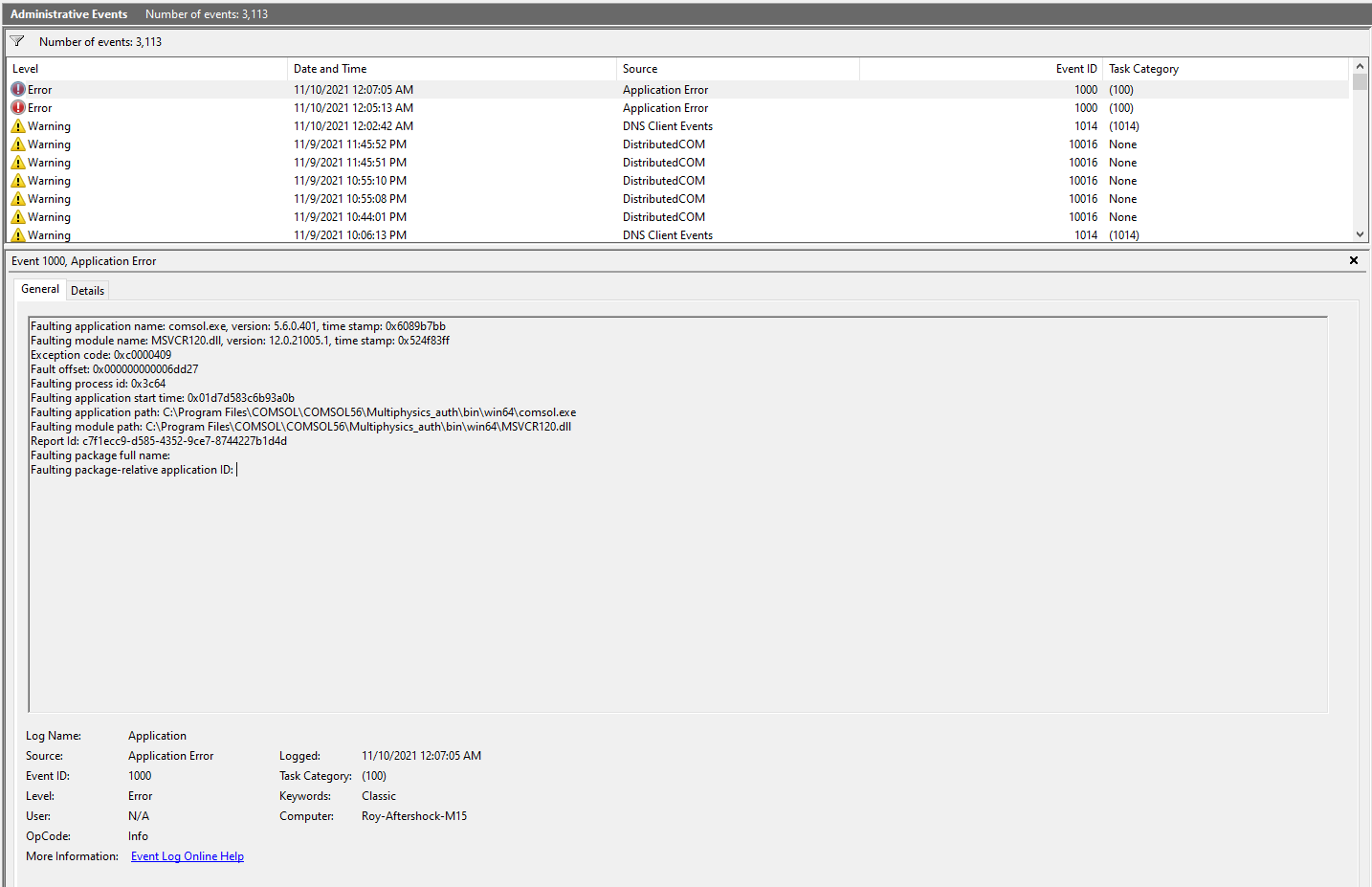

Hello! I am attempting to install COMSOL 56 using the online installer on a 64-bit version of Windows 10. COSMOL always crashes upon starting. My computer system inform: Processor: Intel(R) Core(TM) i7-7700HQ CPU @ 2.80GHz 2.80 GHz RAM: 16.0 GB (15.9 GB usable)
Below is the error information form the Windows Event Viewer:
Faulting application name: comsol.exe, version: 5.6.0.401, time stamp: 0x6089b7bb Faulting module name: MSVCR120.dll, version: 12.0.40649.5, time stamp: 0x56bc00d3 Exception code: 0xc0000409 Fault offset: 0x000000000006dd27 Faulting process id: 0x2e4c Faulting application start time: 0x01d7d1244e5820ad Faulting application path: C:\Program Files\COMSOL\COMSOL56\Multiphysics_auth\bin\win64\comsol.exe Faulting module path: C:\Windows\SYSTEM32\MSVCR120.dll Report Id: e77aad8d-4910-4bc4-9a67-1cfb0c616611 Faulting package full name: Faulting package-relative application ID:
The issue happens because there is already a MSVCR120.dll in my C:\Windows\SYSTEM32 which has a version different from the MSVCR120.dll used by COMSOL5.6. This MSVCR120.dll seems has been actively used by my NVidia software so it cannot be modified.
I have tried run ext/vcredist_x64.exe, however the version of MSVCR120.dll would not be able to change.
Really wish anyone who may experience the same issue to help.

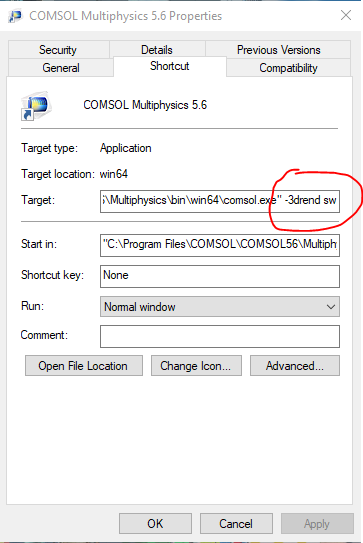

Have you tried starting COMSOL 5.6 using software rendering? You can set it up before launching COMSOL in the preference file in the .comsol directory under your user directory as
graphics.rendering.3drend=sw
(the default is ogl for OpenGL rendering)
Best regards,
Magnus
Hi Magnus,
Thank you so much for the suggestion. I have tried with adding " -3drend sw" into the target line in shortcut.
The same issue still happens and nothing changed. I guess it may not be the rendering issue.
