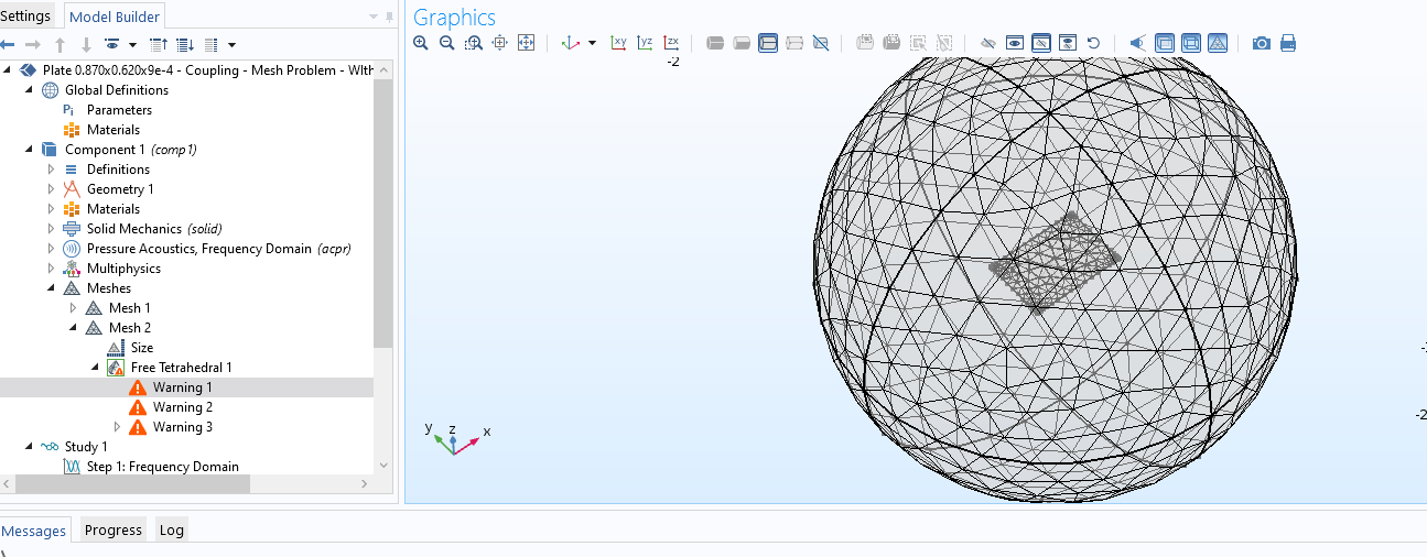

Hello Magnus, how is it possible? When I set a mapped mesh for the plate and after a the tetrahedral mesh for the sphere the second is overwritten to the first..

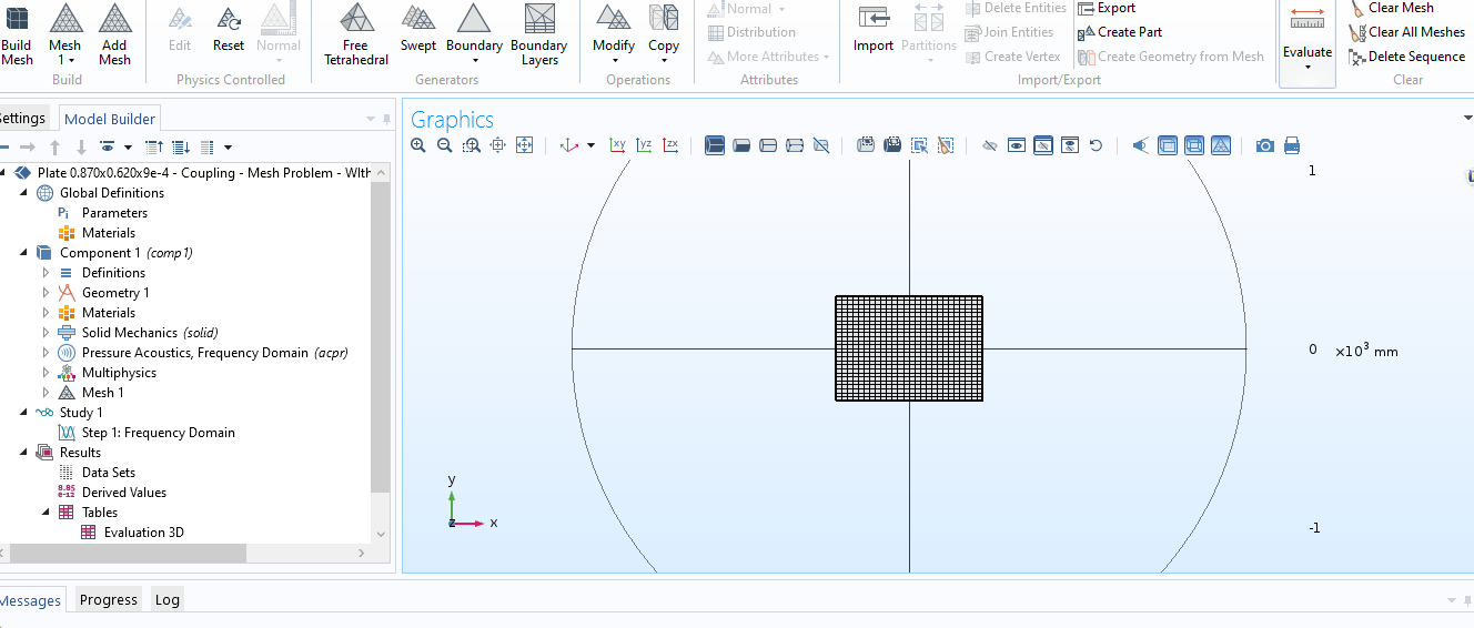

First create a mapped mesh on the plate and then a terahedral mesh on the remaining geometry (that is, the sphere surrounding the plate). Don't continue by meshing the entire geometry using tetrahedra.

Thank you Magnus, I will try again. Thank you very much. To cut the geometry and visualize both meshes you have used a workplane right? Thank you in advance! Ps. Sorry but I have been working with Comsol for only 1 month and I am learning. Best regards, Giada

I used a Clip Plane to interactively look "into" the 3D geometry. It is available in the most recent versions of COMSOL Multiphysics (5.6 and 6.0).
