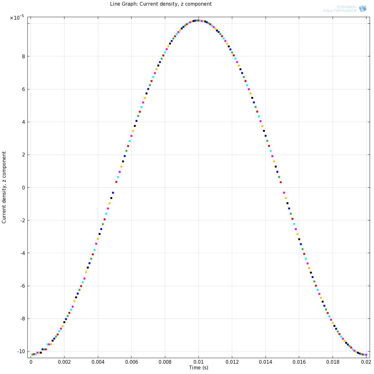

I made a electric field model with two electrode and single material between them. And the material permittivity
consists of real and imaginary permittivity such as A-i*B.
By applying a sinusoidal voltage on the electrode, the resultant current was supposed to contains both capacitive and
resistive components, so the current was supposed to leading the voltage 0-90 degree.
BUT now it is lagging behind the voltage exactly 90 degree. It seems that the imaginary permittivity of the material
does not influence the resultant current no matter how I change the value.
I am looking for the interpretation of this result.
Thanks.
Sam

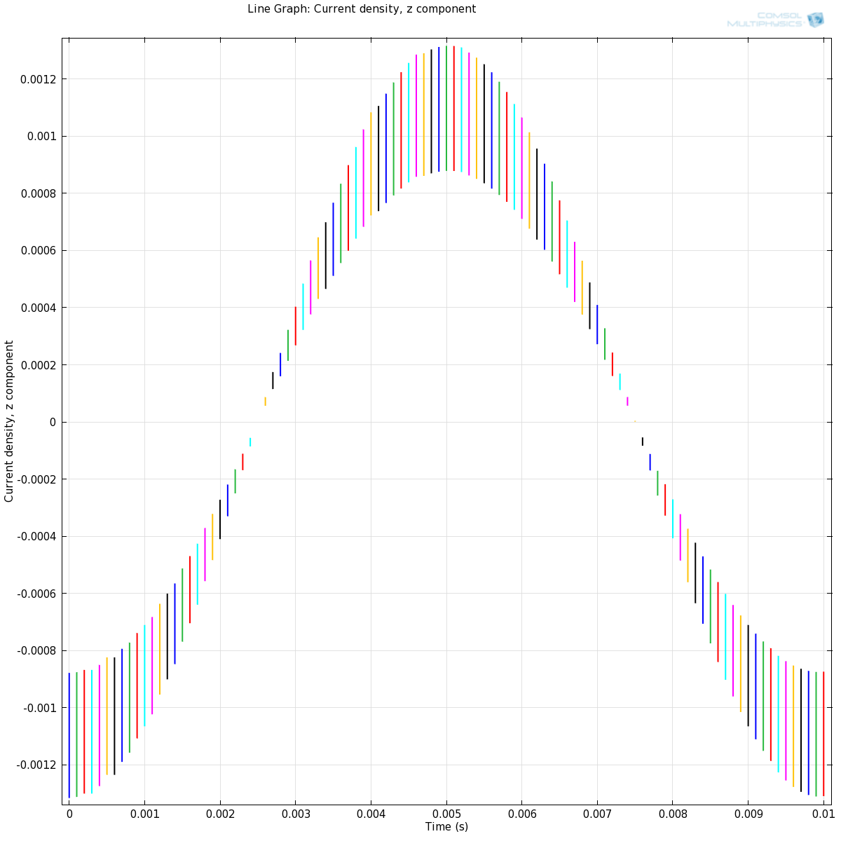

when i insert two different material in the electric field,
the current curve was different from the previous one with single material which one dot represent a current value
become one line as the figure i attached.
but the result when i make the line integration on the gound electrode was one value at one time.
thanks.
Sam
