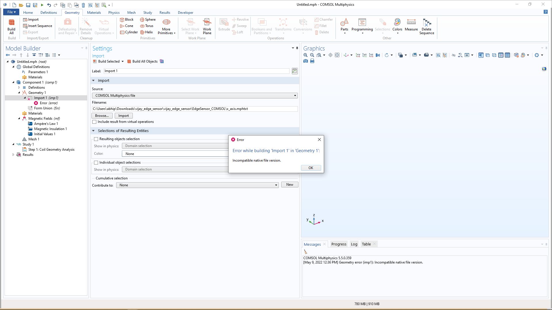

Hi, I have generated x and y coordinates in MATLAB for a square spiral coil, which is saved as a .txt file. I am having trouble importing the coordinates to COMSOL. 1) What type of file does COMSOL accept? 2) In which format should the coordinates be saved to be imported successfully?
