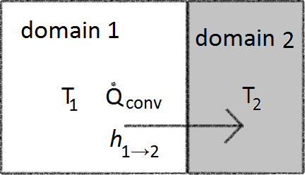

I am trying to setup a convection between two domains. An issue I have is that the boundary condition "convective cooling", defines the external temperature (or environment temperature) as predefined parameter and fixed number. In my case the external temperature is subject to change and should be able to decrease. This decrease in temperature is a result of the convection between the two domains.
I have added an image explaining the situation.
Thanks for any help!
