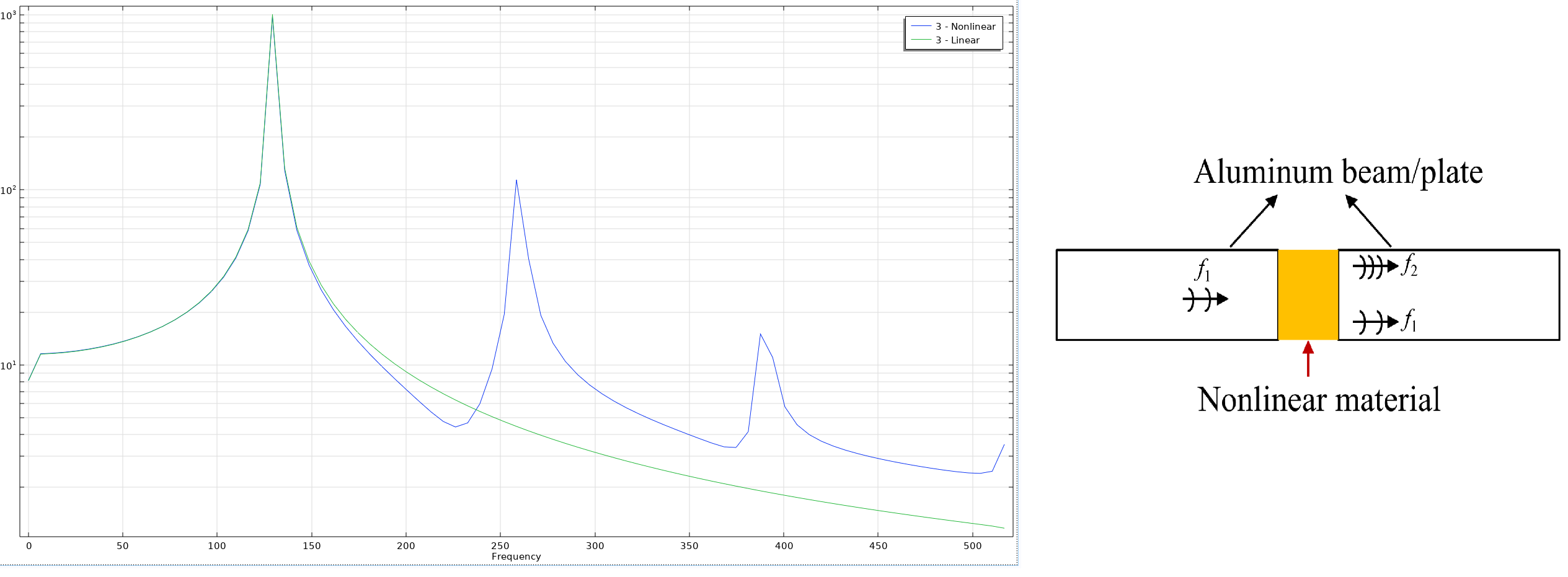

Hi Jackie,
See Structural Mechanics Module User's Guide, version 6.1, page 64: "In a frequency-domain analysis, you study the response to a harmonic steady state excitation for certain frequencies. Such a steady state can prevail once all transient effects have been damped out.
The response must be linear, so that the single frequency harmonic excitation gives a
pure harmonic response with the same frequency." . That condition does not seem to be met by your system.
Best,
Jeff

Hi Jeff,
Thanks for your reply! Maybe I need to try time domain simulation then.

It may be useful to run a linearized frequency-domain study at the fundamental frequency in order to obtain approximate initial conditions for the time-domain analysis.
Here is an example showing that approach:
https://www.comsol.com/model/nonlinear-harmonic-response-105171
