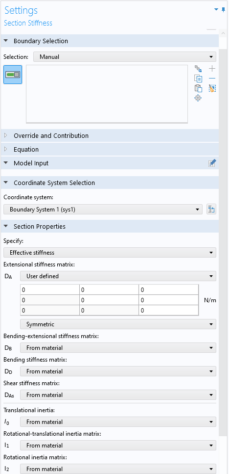

Edgar,
The key here is the Section Stiffness material model in the Shell interface. So, if you can compute the extensional, bending, coupling, and shear stiffness matrices one way or another (maybe Excel), you can enter them there. For dynamics, you would also need the various mass/inertia matrices.
This material model can be applied for linear problems, as long as you are not interested in the per layer stresses.
See the attached screenshot showing the settings pane.
I cannot think about a sutable example right now, but in https://www.comsol.com/model/material-characteristics-of-laminated-composite-shell-67691 the ABD matrices are extracted from a full layered model. Such matrices could be directly entered into another non-layered model with preserved stiffness properties.
