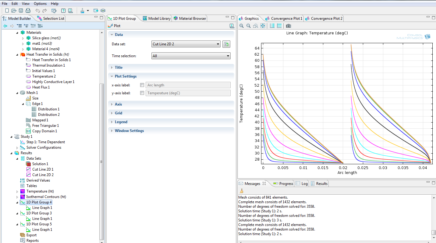

I noticed that you can plot both case studies on the same axis. How did you do that? I would appreciate if you can point me to the relevant document.
Susant
Hi Ivar, Thanks! The layer dimension was at error. The results are quite close. I noticed that you can plot both case studies on the same axis. How did you do that? I would appreciate if you can point me to the relevant document. Regards, Susant
Posted: 1 decade ago 2012年10月20日 GMT-4 06:31
that is easy, when you select a line plot, and you select edges, by default COMSOL assumes these are joined as a long (poly-) line, if not, that means these are dsjoint, then the default "arc-length" for the horizontal axis cannot be defined.
You simply go the the horizontal axis tab of the line plot sub node and set in a user expression such as x, or r (in 2D-axi) or y,z ... even you can plot flux versus T temperature if that makes some sens (typically with table plots). Then your edgs might be fully disjoint.
