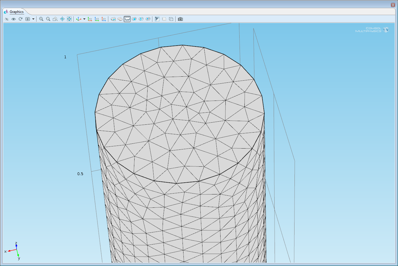

I have been having some issues meshing a cylinder. When you define a cylinder in COMSOL, it splits the curved face into 4 quarters, and as a result, when I went to mesh the cylinder I was irregularities at these 4 points, where the mesh is clearly trying to conform to these 4 lines.
I would like to know how to solve this problem, so that my mesh is uniform around the length of this curved face. I have tried to get COMSOL to ignore the four edges, and I have also had it make a single composite face from the four individual ones. In both cases, when it came to meshing, the mesh acted like these lines were still there.
Any ideas?

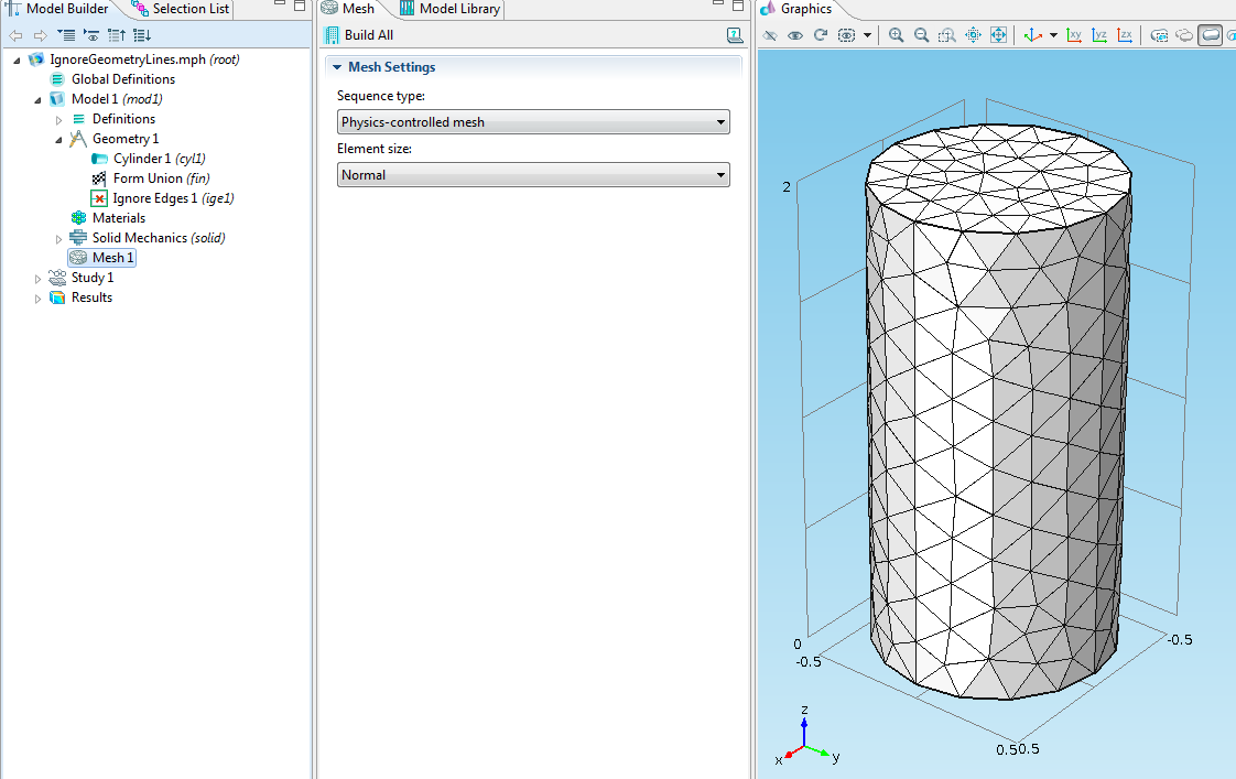

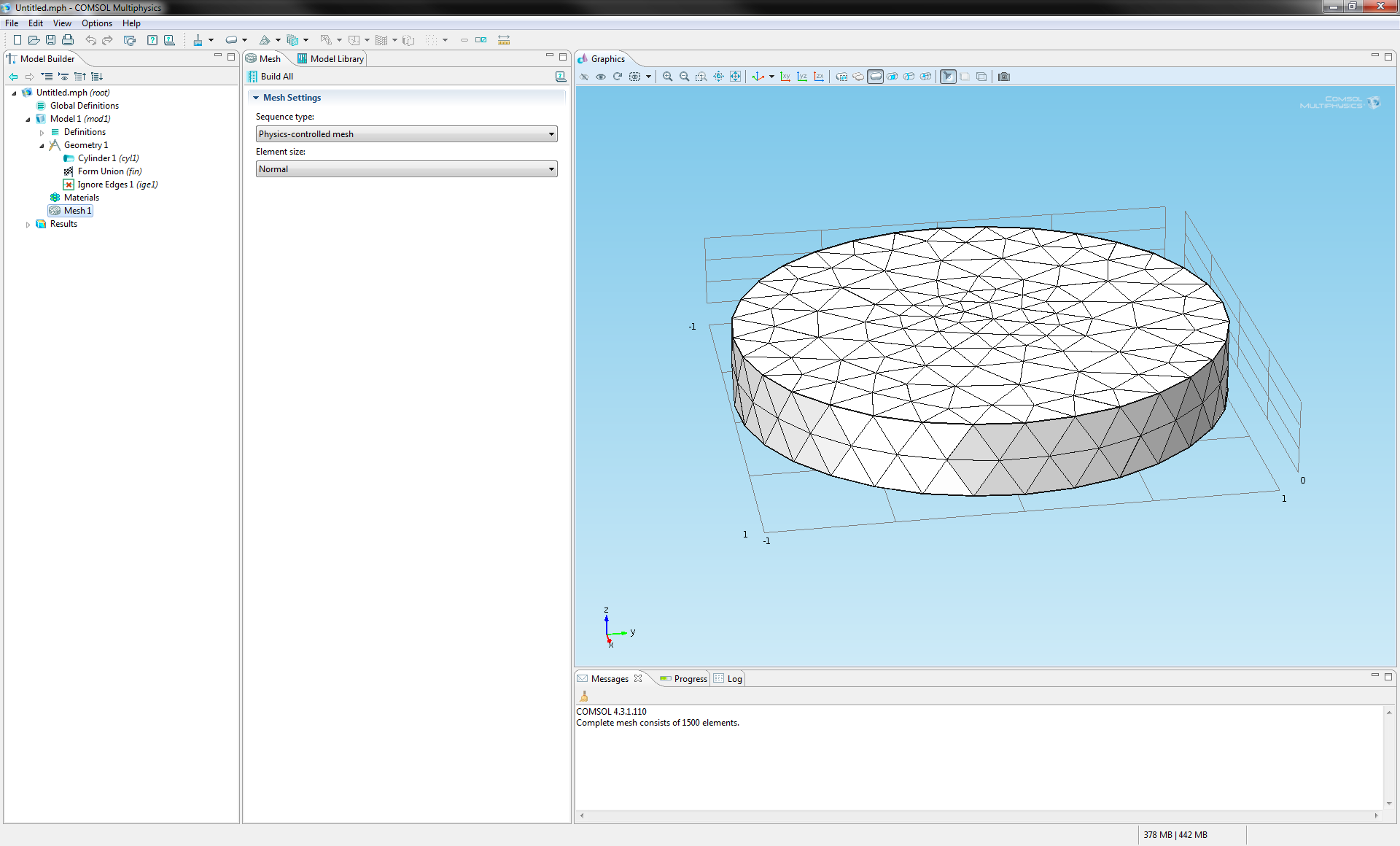

I don't know if Blair is saying it in the last message, but I get rid of the lines if I ignore BOTH the vertices AND the edges of the cylinder. I send the image.

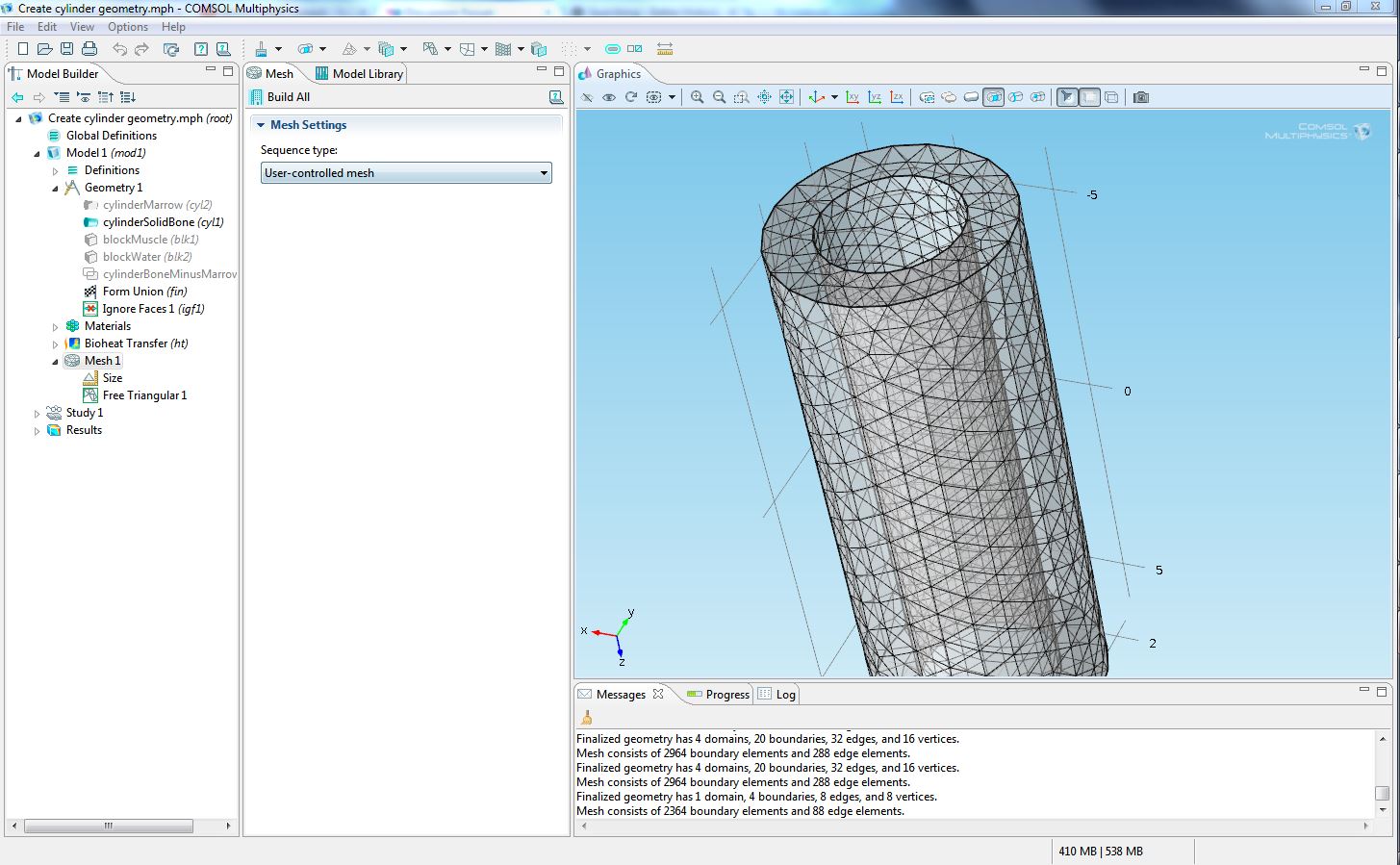

I stumbled upon this thread trying to create a hollow cylinder mesh in COMSOL.
Suffice to say all your help did not help, at least not for COMSOL 4.3b.
The way I did manage to mesh my hollow cylinder (as can be seen in the attached image) was by ignoring the inner faces while keeping the checkbox "ignore adjacent edges and vertices" checked.
COMSOL 4.3b solution:
geometry→right-click→virtual operations→ignore faces

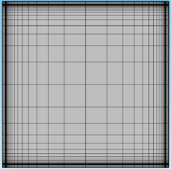

I have a little bit different question but on the same topic -- meshing a cylinder.
As you mentioned we can mesh on one surface and do sweep all the way to the one surface. However, I cannot find a way to mesh structured grid on the source surface which can be easily done on rectangular surface, please see attachment if you don't mind. In that picture, I have extremely fine mesh near the four walls (almost like black strips) where my boundaries locate.
So if I want to do the same thing for a pipe, extremely fine mesh near the walls, could I accomplish this task in comsol by any ways?
Thank you very much.

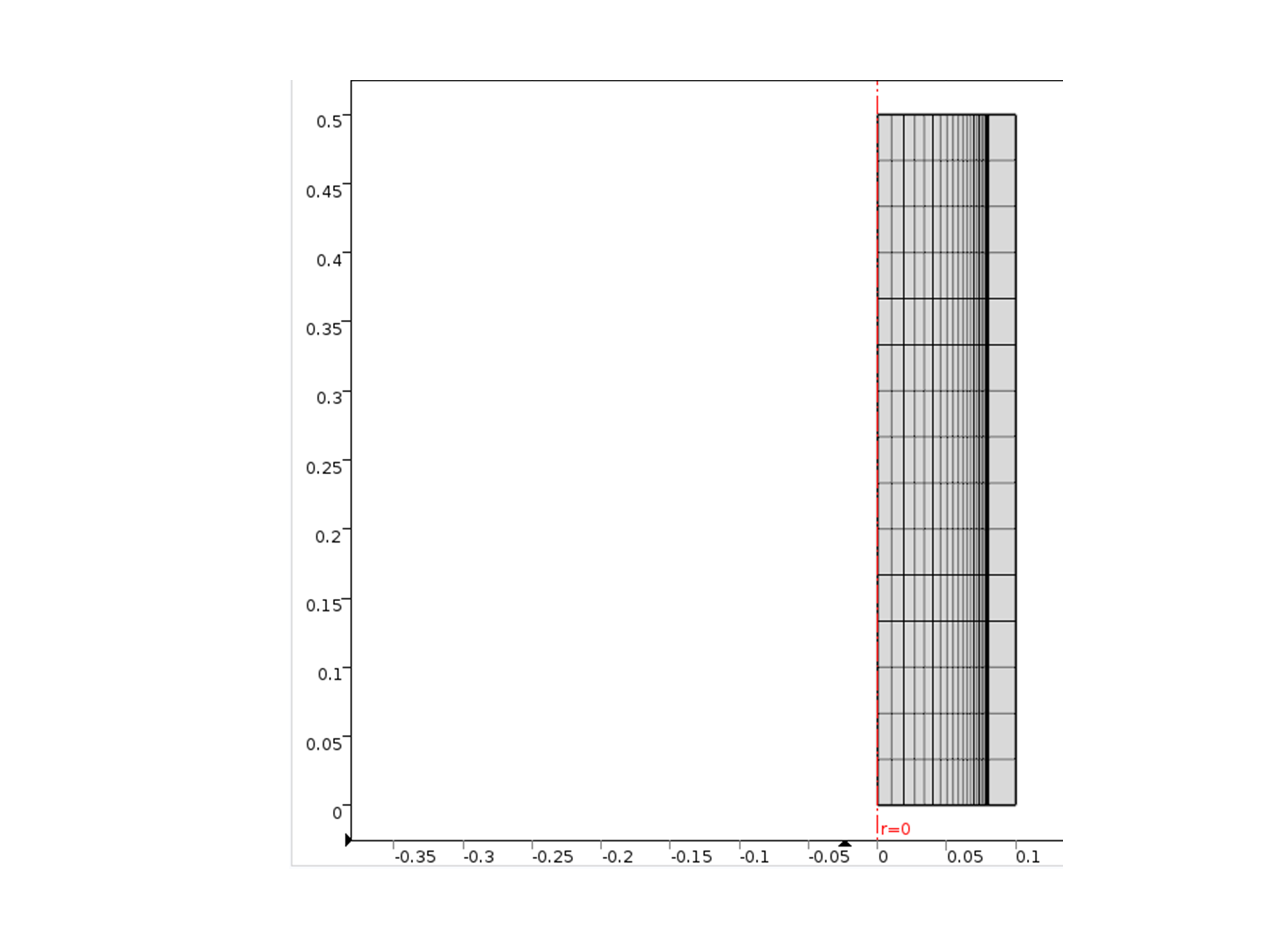

If you can use 2D axisymmetric model, it can be done with meshing first the top and bottom of lines with
Edge --> Distribution -->
and then mapped mesh in the pipe. See attached a suggestion.
