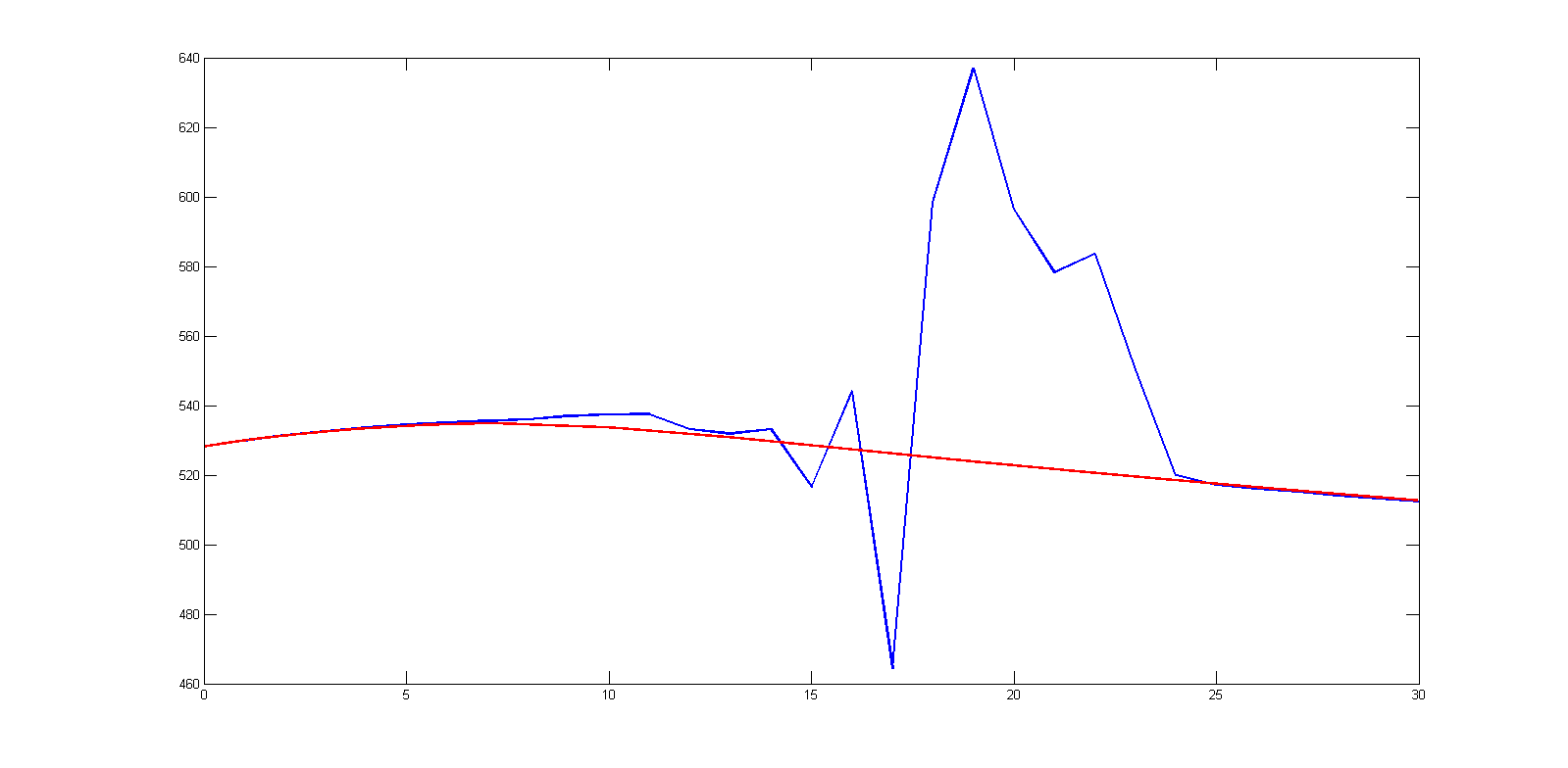

My dependent variables are p, u, T and Tm, as can be seen. But when I plot the temperature i have a wrong result (blue line).
I compare this result with other simulation, without use a loop 'for' (in red line). For this case I run the model from time = 0 to time final, don't using the interpolation.
The image is in attach.
Anyone have the same problem?
