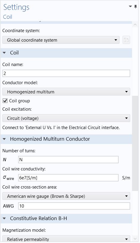

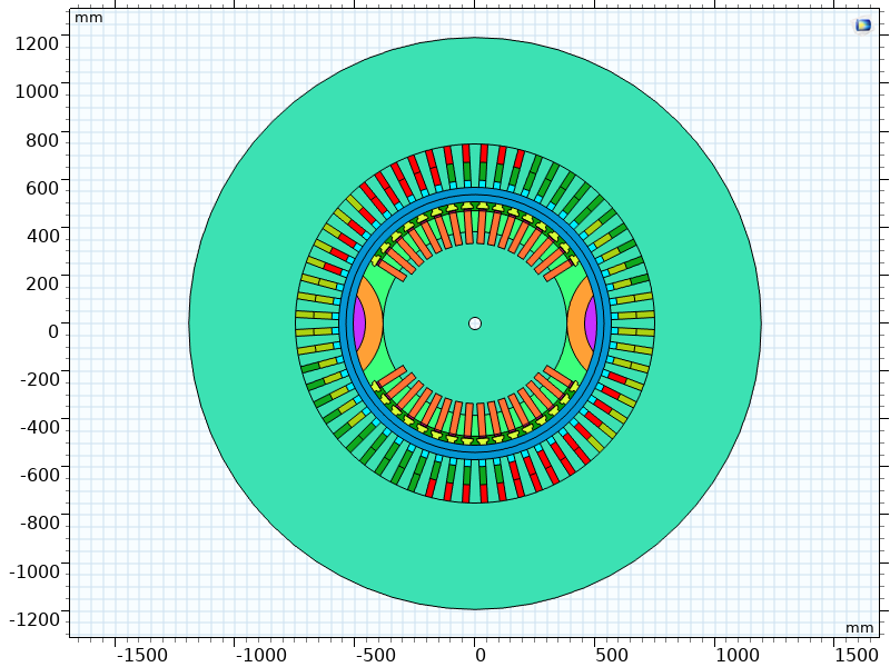

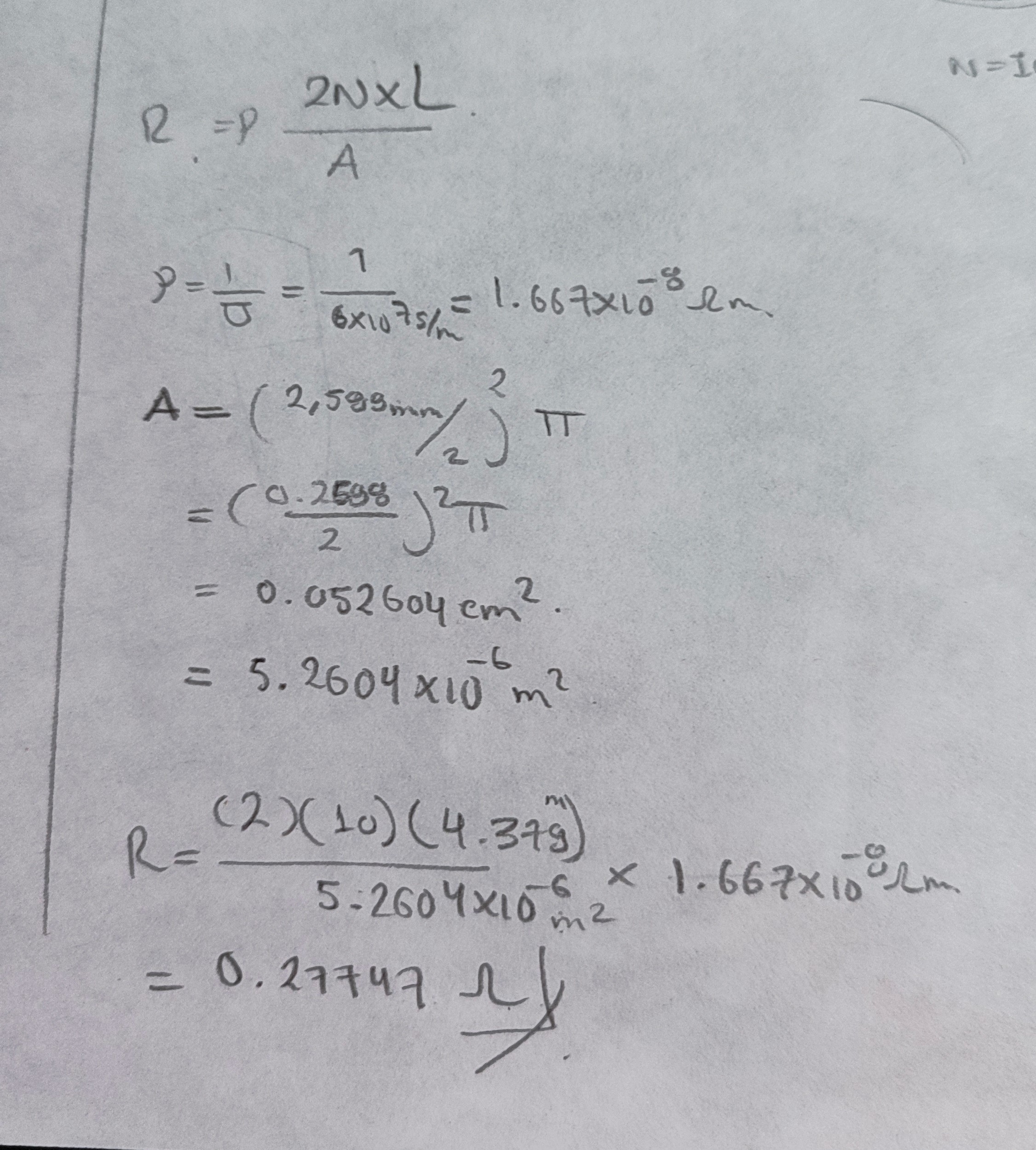

I would like to calculate DC resistance per phase of a three phase electric generator. I would like to know how COMSOL compute it. I'm working with a 2D model of synchronous generator in a time dependent study. The data are: Sigma_cu = 6e7[S/m] AWG = 10. N = 10 turns per phase. I had have the compute, it show in the image. I've a resistance of 0.27747 ohms per phase but comsol compute: 5.5473 ohms per phase. (I had to negligible the coil's external lenght). Regards.
