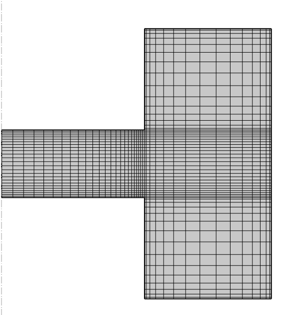

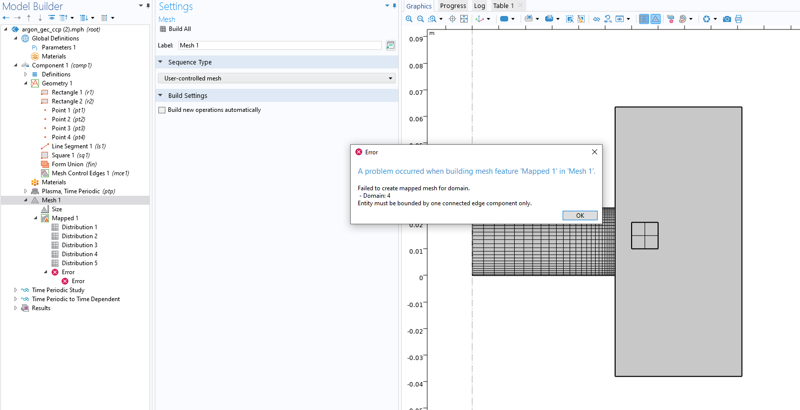

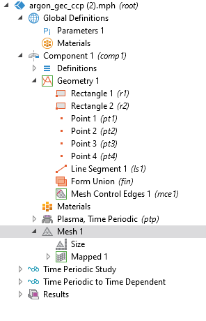

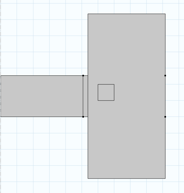

Hi, everyone. I downloaded a plasma model from argon_gec_ccp and want to put a primitive model there. In the future, something more complex. The problem is with the mesh, if it's something other then correct me, please. I don't know if this will work. There is a mesh error in the domain where I want to place the geometry. I don't know what the best solution would be for this problem. I'm attaching screenshots.
