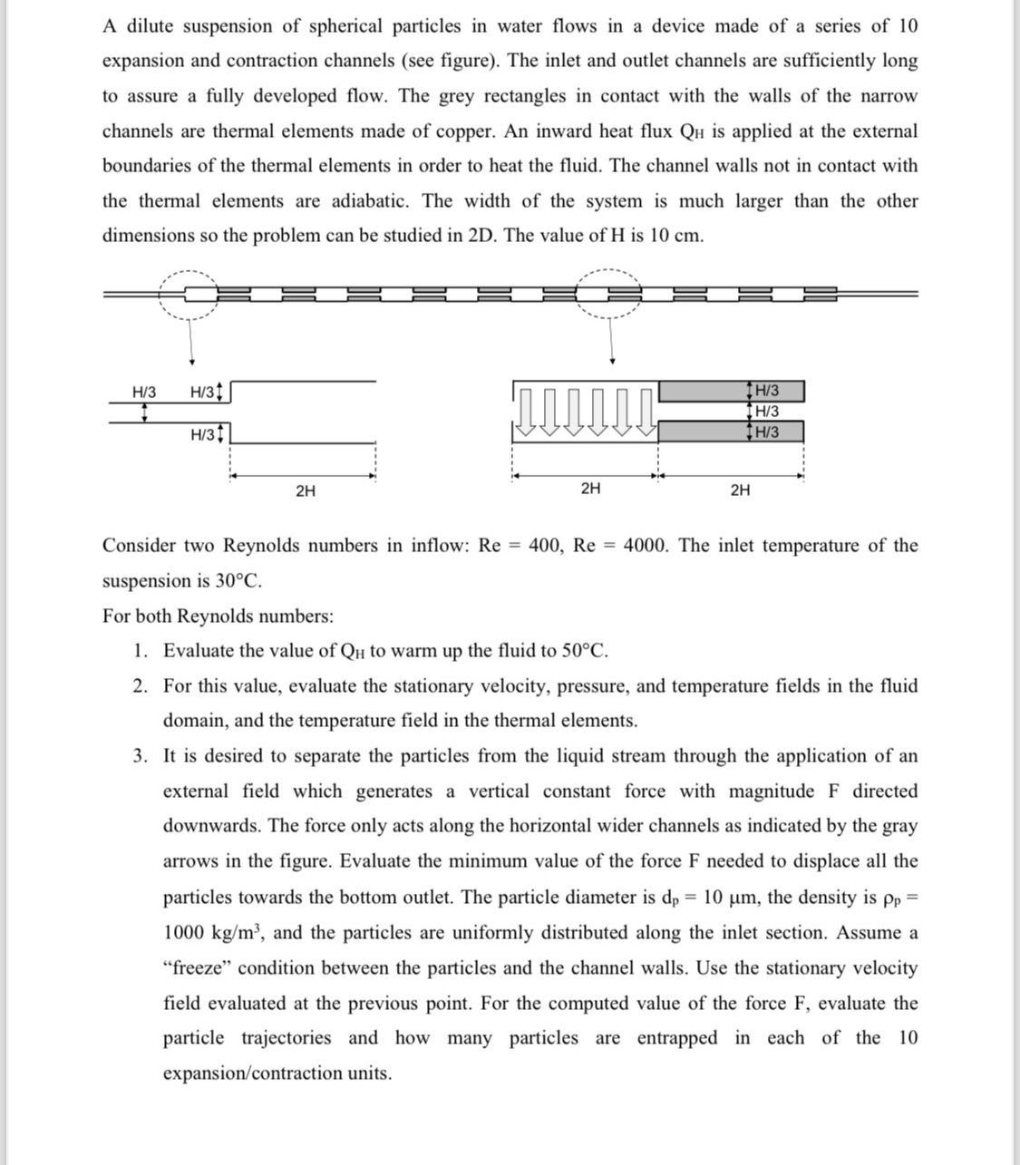

I have a 2D non isothermal laminar region for Re=400 as I am running particle tracjectories so the particles are not moving downwards ( they are not moving). In study (2) time independant I have set output time range (0,10,100) and selected drag force and normal force (x=0 and y= -50 as particles are acting downwards that why minus sign). I need help in this regard??
