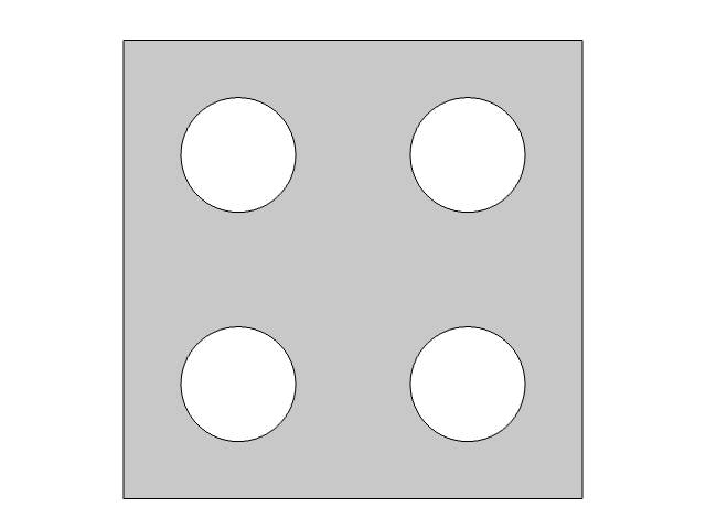

What Comsol options should I use to properly define periodic boundary conditions (PBCs) for solids with uniformly distributed cylindrical holes? Unit cell is presented in: (unit-cell-1, unit-cell-3)
Some Comsol helps does not help to solve the problem of compressing / stretching the unit cell.

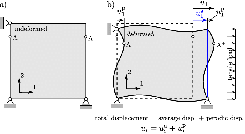

Sometimes it is not possible. See attached figure unit-cell-4.
How to make boundaries deformed after PBC will be applied with loads?
