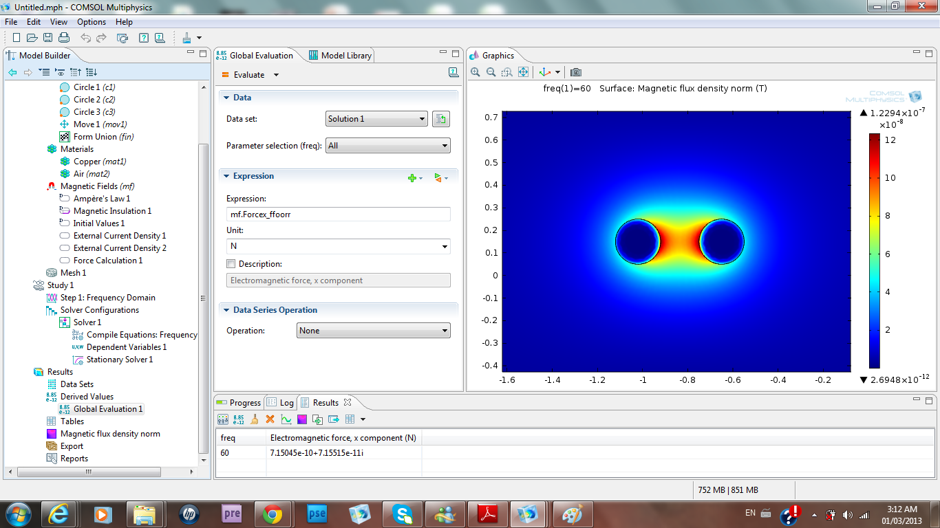

I am running a simulation to calculate the force between two conductors carrying AC current. I used MF with simple two circles of copper and surrounding of air. I set current density 200 in z direction and -200 on z direction for the second coil. The magnetic field looks great and as expected. But you can see the force evaluation in the bottom of the picture, it is complex value!
Does it mean it is sinusoidal? Even if, this means that the average force is zero? this is not true because there should be a net repulsive force.
Please help me with this problem, Thank you.

Hi, Ashraf, sadly it's been around two years since you posted your question. I'm currently working with obtaining electromagnetic forces in a frequency domain study too. A frequency domain study implies a phasor representation of field variables, which adds a complex exponential to their values. However, their actual values should be evaluated by taking their real part. This applies to forces, as well.
On the other hand, there are two ways to compute electromagnetic forces in Comsol. One of them is readily available as the electromagnetic force, which is the one you are using as I can infer from the picture you attached. The other one involves a surface integral of the Lorentz contribution, over the domain of interest. These two can give different results.
I'd like to hear if you continued or concluded your work and about your experience.
