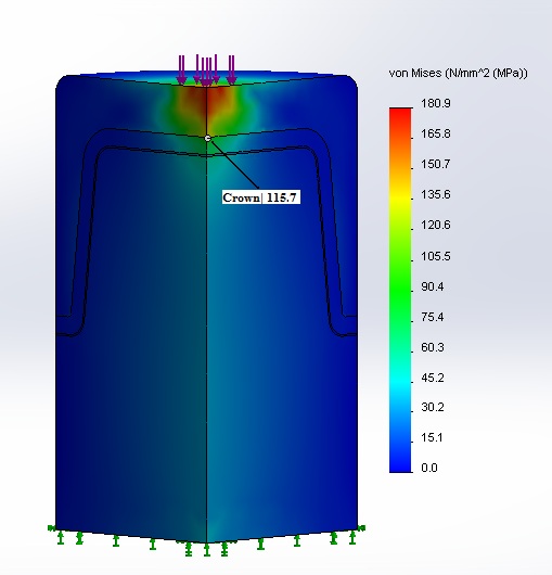

I had an assembly in SolidWorks made of 3 parts. I created a new SolidWorks part file which had the 3 parts mated together correctly and saved it. I imported that SolidWorks part into COMSOL. COMSOL recognized it as having 3 domains which I assigned different material properties to. I fixed the bottom and applied a load on the top. When I ran a tetrahedral static solid model test, the stress was what I expected for the top layer but it appears that it did not make it to the remaining layers. The stress on one side of the interface is a magnitude different than the other side, right at the interface. I attached a picture of this.

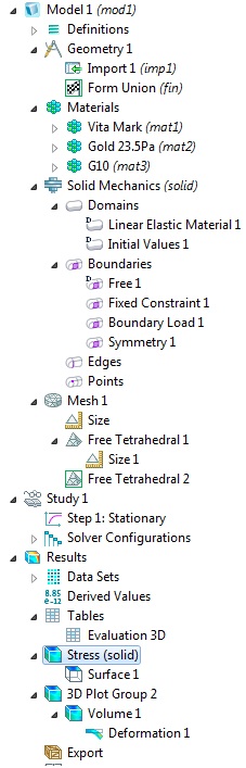

The nodes seem to align at the interface too. Even when I used the same mesh size for the entire model, I had the same issue. Does anyone have suggestions on a solution? I also attached my setup.

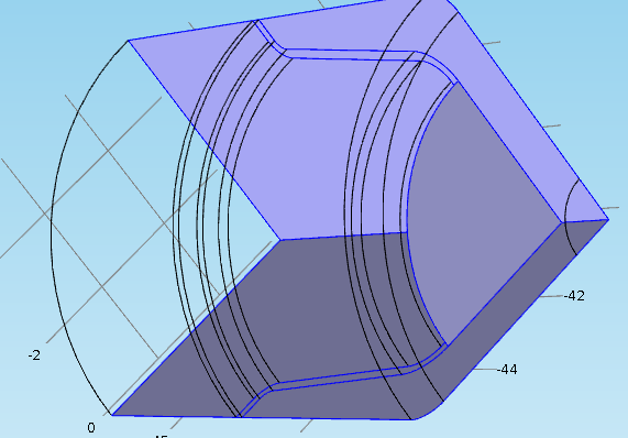

Common mistake that is easy to make: You have part of the interface between the top and middle layer accidently defined as a symmetry boundary. See attached screen shot. These mistakes are hard to spot when boundaries are opaque. In the future, I would recommend checking all b.c.s using the wireframe mode.
Also, unless you are running non-axisymmetric loading conditions in the future. I would highly recommend running this model as 2D axisymmetric. You will get a huge savings in memory and not lose any information.
Also, if you do want/need to run the 1/4 symmetry. You can probably decrease the mesh resolution. At least for debugging purposes so you aren't running 6 million DoF until you absolutely need to.

When I ran the test again with those changes, I found that the stress jumps by 50% as soon as the interface is crossed. 95 MPa to 54 MPa. If the nodes at the interface are aligned correctly, I would expect the stress to be the same at the interface since they should share the same nodes. I also don't know of an easy way to find the stress at the nodes of the interface.
I attached "Comsol test" which is my COMSOL result and "Simulation" which is my analysis using a different FEA program.
Do you know why COMSOL's results don't match?

Thank you for the thorough responses. I have been working with a couple people to understand my results.
This may be what you were saying but this is what we came up with:
If the model is graphed as Z tensor stress, the stress is fluid across the layers. In 1D, stress would be P/A.
With Von Mises, triaxial stresses as well as shear stresses are all factors. There are large radial stresses in my model, creating the stress "jump" which "looks" like a discontinuity.
