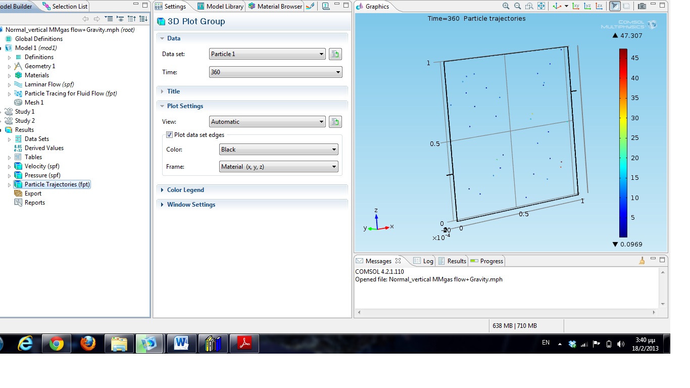

I am a rookie in comsol multiphysics and i need a little help with my model....
I have a chamber with dimensions 1m*1m*0.005m (x,y,z). I'm using a work plane to minimize the ram geometry.is that correct...;
The domain has Air and i want to loaded with Argon.
I also want to see the concentration of Argon inside my chamber and an animated flow of argon.
Actually i want to see the flow of the argon inside my chamber, it's movement .
I'm using the laminar flow (stationary and time dependent) and then the particle tracing for fluid flow.
Laminar flow
Inlet : flow rate = 5lt/h (or gas velocity, u=0.19m/s).
Oulet: pressure, no viscous
Stationary (or time dependent)
Particle tracing for fluid flow
Oulet: pressure, no viscous (dissappear)
Wall : bounce
I sent also a photo from my simulation-geometry. Please tell if there is a model better and more simple than mine.
am i wrong; I need to refine this modelor I need use different physics;
Thanks , a priori.
