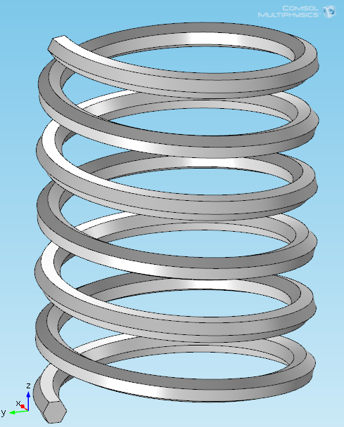

Use Parametric Curve and Sweep options to create helix of arbitrary cross-section. Example is shown in the attached file.
Sergei

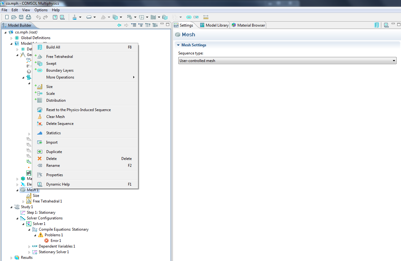

you might need to adapt the twist angle ;) and for defining the number or distribution type of points along the sweep direction you have the "dimension" sub tab on the mesh node to play with. Check the doc, there are many subtleties in the meshing part
But I didn't see "dimension" sub tab on the mesh node(see attachment)... Or is it possible to use a for-loop directly in comsol?

sorry my fault it's "Distribution",
read the doc about the mesh nodes, its important to understand in which order you call them and the difference of a major node and a sub node, performing a few of the model library examples helps too, at least those (or the video) about the meshing

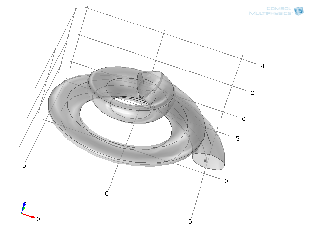

There are two parts that I need help in my model attached.
~ How to taper the cross section along the parametric curve to avoid overlap of material (in current model I increase the radius and height to avoid it which is non-realistic), supposing I know the tapering function
~Is it possible to extrude the workplane in the direction of the curve without any twist. i.e. the corss section is always perpendicular to the base plane(xy-plane). just like the attached image, I think it might be achievable. Otherwise, since I don't know the function of twist. It would be impossible to track the path of a specific point of the workplane which is actually very important for me.

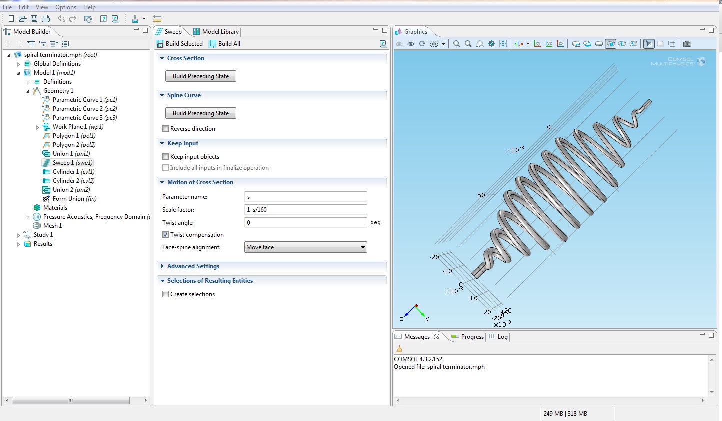

I manged to get a tapered helix by putting 1+f(s) (where f(s) is the function of s required) in the scale factor box.
Im not sure what the scale or bounds of 's' are or where you would find these

I dont know how to save as a previous version so here is a screen shot the important bit seems to be the 1 in the scale factor box.
I would still like to know what the bounds on the parameter s are.
