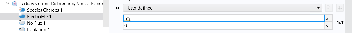

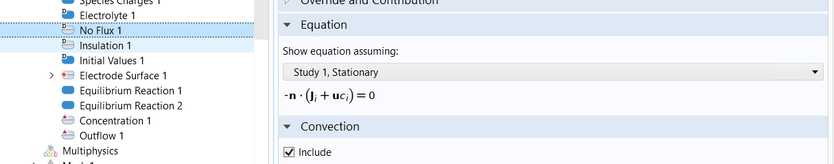

Hello! I am trying to implement the flow velocity in my corrosion model for pipelines. I am using the Tertiary Current Distribution, water-based with electroneutrality. I am using the convection section at the Electrolyte node to input the velocity field. I also have the convection check-box marked at the No Flux node. Would this be the correct way to implement the velocity?
