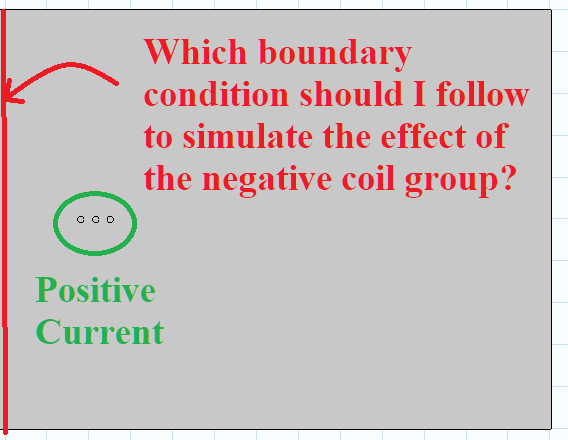

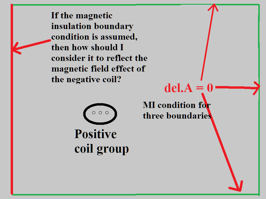

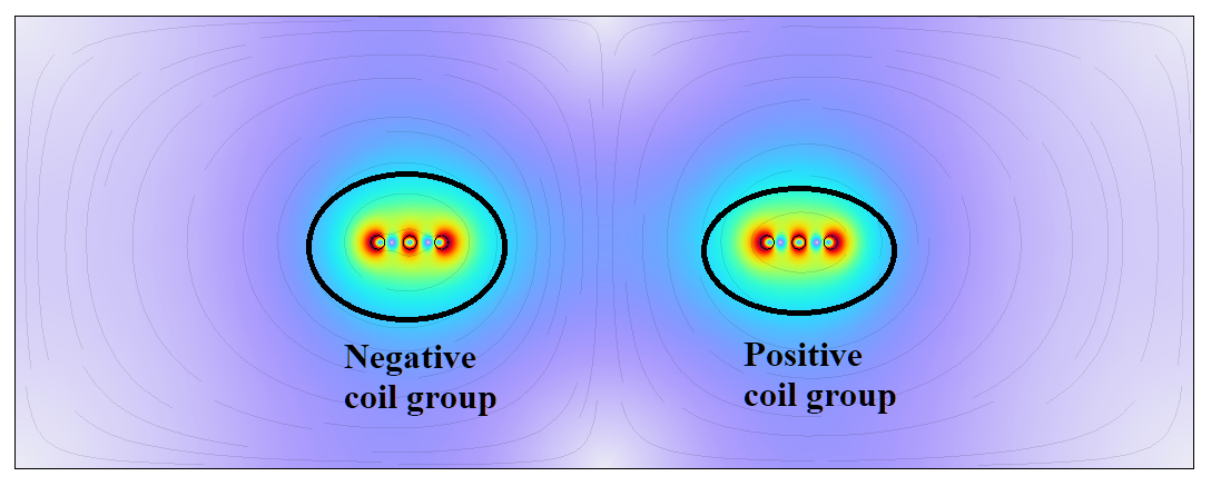

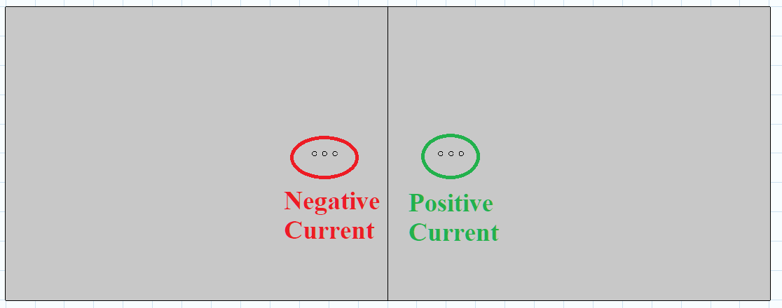

Next, I want to speed up my simulation by performing half-symmetry conditions in my model. However, I am unable to model the return path.
Which boundary condition can I use for 2D simulation (not 2D Axi-symmetric) in the Magnetic field interface? I have tried all different boundary conditions like PMC, Symmetry plane, but I still have not found any correct solution. i.e. inductance value is not converging.
Please see the attached PNG file for more clarification.
Magnus Olsson, I am eagerly waiting for your response.
You should not choose boundary conditions based on wild guesses or simply seeking/hoping to find a choice that allows your program to execute to completion. Rather, your boundary conditions should always (at least reasonably) represent the actual/relevant physics of your problem. With that in mind, consider the right-hand rule. If you line up your right-hand thumb with the current direction in a long straight wire, the magnetic fields due to the current in that wire will wrap around it in the direction of your fingers. If you now do this with each of two parallel wires, carrying equal and oppositely-directed currents, then you can see that on the symmetry plane between them, the vector fields must be purely tangential (i.e., there will be no normal component of H). And that corresponds to the "magnetic insulation" boundary condition in Comsol Multiphysics.
-------------------Scientific Applications & Research Associates (SARA) Inc.
The system never closes the magnetic path properly in a standard 2D plane → the field extends to infinity, and you can’t capture all the magnetic energy unless you model infinity correctly. Also, try to find a possible better way to make this happen.
