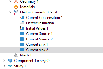

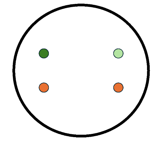

    Failed to find consistent initial values.
The physics: Electric currents
The equation I used: (the polarity changes)
Io*sin(2*pi*f1*t)
- Io*sin(2*pi*f2*t)
Io*sin(2*pi*f1*t)
- Io*sin(2*pi*f2*t)
Note: though the are two current sinks under the electric current, these are Current source as well. (I know, in Electrochemistry Module there is a designated module to current sink, but I do not have access to it. )
