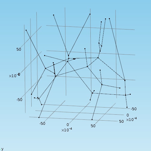

I need to have a simulation of electrical potential in 1D beam elements in a structure. I want to give potential to one point of the model and ground to another point and observe the current flow inside the beam. in fact I need to calculate the whole electrical resistance inthe structure.
when I use Electrical Current in AC/DC module, it tells me that it is not applicable to select a point as a "point electric potential" or "point ground".
I have attached a picture of a sample structure.
How can I do this. should I use another module?

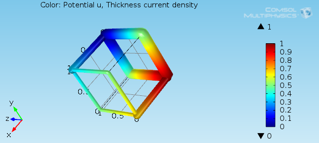

as there is hardly anything that can't be done in COMSOL there is also a solution for edge currents in 3D.
You can very easily use the coefficient form on edges to model that. The attached model shows a wire cube
(the kind that electrical engineering students at my study time needed to solder in their base practicals).
Two corners are connected to ground and a potential. The picture shows the potential and the current density.
For symmetry reasons one branch is completely current free.
If you want to wrap that equation into a physics interface you can also do that using the physics interface builder.

Hi Ehsan (and Edgar), as there is hardly anything that can't be done in COMSOL there is also a solution for edge currents in 3D. You can very easily use the coefficient form on edges to model that. The attached model shows a wire cube (the kind that electrical engineering students at my study time needed to solder in their base practicals). Two corners are connected to ground and a potential. The picture shows the potential and the current density. For symmetry reasons one branch is completely current free. If you want to wrap that equation into a physics interface you can also do that using the physics interface builder. Best regards, Sven

correction: two edges are current free

Thanks a lot for the model you sent. It solved my problem :)
