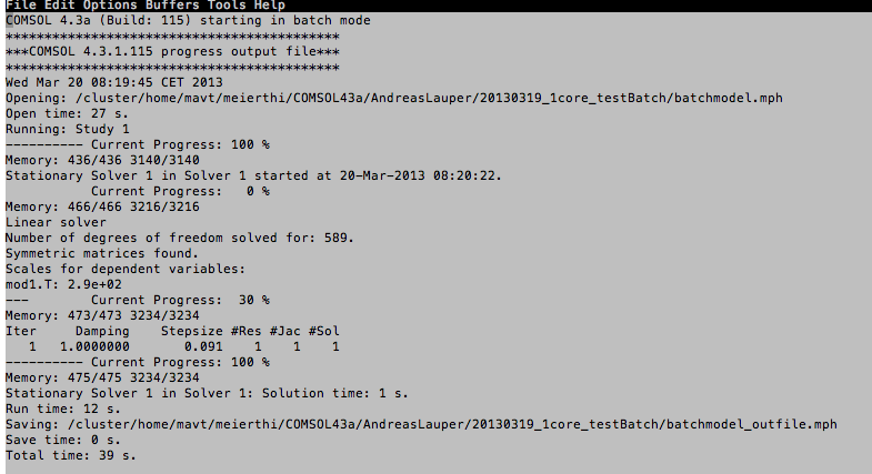

Moreover, I am running heat_convection_2d.mph tutorial. And when I run the batch locally (directly from the COMSOL interface) everything is fine (see also attached logs -localBatchLogs.jpg-).
