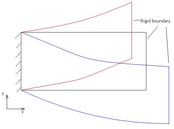

I have the structural module v3.5a, and I've been using the prescribed displacement BC, but I can not achieve my goal. Actually, what I need is a boundary condition of a super rigid wall (see example in attachment), which should not bend (must be parallel to 'y' axis), but it can move in any direction due to some external force.
I also tried with a new Coordinate System, but I haven't been able to obtain this result.

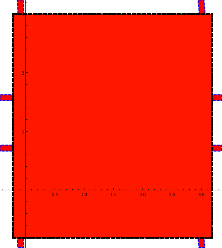

thank you for the answer. Let me quickly introduce the problem. In model.png there is a periodic unit cell. No matter what happens inside the cell, ends of these ''beams`` should remain compatible in terms of translation the unit cell. In other words the boundaries should be the same due to the periodicity (right-left, top-bottom).
My plan was to put left and bottom beams ends on the roller. For right ends there is a prescribed Rx and free Ry.
Until now we have all ends horizontal or vertical. The only boundaries to be constrained are the upper ends of the beams. That's why I wanted them to stay horizontal. But I realize this approach is not perfect.
Do you have an idea how my goal could be achieved?

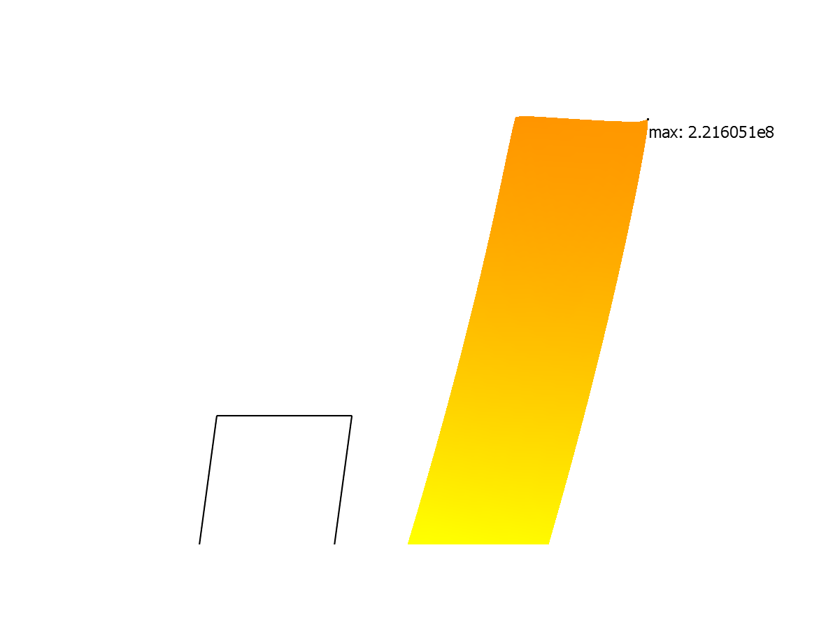

In fact I'm realising only now, what you are asking for is a "zero rotation Rz" since you allow the motion in "x" and "y" but you do not want the line to ROTATE.
This is possible on a free boundary with some tweaking of the equations. For some reason (still not 100% sure why, could be that its only of specific use in structural hence not "general enough" for the COMSOL developers, but pls do not hesitate to remindthem so this will once be implemented for the structural !!) the antisymmetric tensor representation of the deformations is not implemented, you have to write it out by hand yourself. The antisymmetric tensor is the local infinitisemal rotations.
In 2D the Rz or rotation along the Zaxis perpendicular to the X-Y plane is the value thz=0.5*(vx-uy) set this as a "Global Expression" in your model.
This is typically explained in books like: "Elasticity, Tensor, Dyadic, and Engineering approaches" by Pei Chi Chou & N.J. Pagano, Dover 1967, chap 2.5, or Theory of elasticity S.P. Timoshenk, J.N. Goodier, ch7 §83 or compare with the definition of the symmetric strain tensor
Then, once you have defined the variable thz, you need to constraint your boundary. This I have only found the "hard way" to edit the equations, by selecting the boundary(ies) (normally it's defined as free but might have an additional load) and then go into the "Physics - Equation systems - Boundary systems - Weak tab"
Edit the CONSTR line (in 2D SMPN there are 3 items for x,y,p, select the y and write "thz" instead of the value "0". This will force that thz=0 hence the angle should not change.
You still need to update the CONSTRF by replacing the second "0 by test(thz), which will adjust reaction forces to get the rotation to remain unchanged. By changing the equations in this matter you will see a small "lock" on the boundary index. This mesn that we have chnaged the eqautzions ina way COMSOL cannot "understand" and locks the boundary equations to avoid "automatic changes". You can always revert to standard COMSOL values by hitting the reset equation tab to the left of the GUI.
That's it you have blocked the rotation along Rz for the selected boundaries (edges in 2D), you can solve and study the result.
It's also applicable to 3D with the corresponding "thx" and "thy" angles. Its usefull with torque loading, but it ends up with many equations, would really have liked to have this "inside" the structural module by default :).
By the way, there is als another way with the weak form where you apply moments and write out the energy equations, probably cleaner, havnt checked that approach yet.
You have an example of two cantelever beam bending with the thz blocked on the upper one, it deforms along an "S" instead of the traditional gravitational load parabola, and the maximum deflection is the same of half length of a free beam (by symmetry). You can also see the reaction torque (arrows) and you can see the stress buildup to maintain the right side unrotated, if you turn on the von Mises surface plot.
