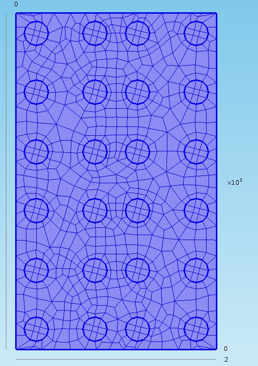

I attached a picture of the model. The created mesh isnt very fine by now, but at first i want to make it work.

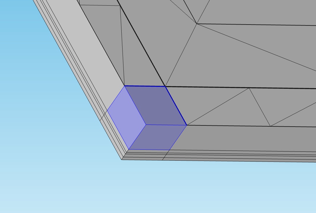

Actually i got a few problems still. i got 5 layers and the same pattern on top layer, botton layer and mid layer. Actually I just want to have this pattern at the third layer, but without also creating it on the mid layer i cant sweep it with the line wich is created by the rubber. I can sweep it until the last layer but there it says that each target area must be unique to one or more source areas. Even i have the same pattern on top and botton surface i cant copy it to the botton surface and mesh it with the existing swept mesh on the top side of it.
Id like to sweep the net down on the last layer and finally do tets on the frame and the rubber in between the laminate and the frame.
Right now im kinda clueless even I tried to mesh the layers from both sides and sweep it. Id be curious how you would solve it and give you the model just to put a mesh on that fifth layer and mesh the frame+ rubber so i could understand where my problem is but this model is a little big for uploading (30 mb). But if you would do it, id be really happy and send it to you via e-mail or something.
But i feel im not that bad by now for studying this programm myself at evenings. I attached the file with some textmarks inside for better understanding.

you are right the sweep mesher requires that all your layers are structured the same way, which means often you need to be clever to use the domain selections to reconstruct your patterns, either during geometry definition and /or after meshing and during material, physis and BC definitions. Try to use the advanced features such as tangeant recognition etc, it saves often quite some time ;)
Creating a new Definition - View and using the hide entity feature often helps to clear the screen for unwanted details or structures, just as extensive se of views with or without the axis preserve scale ratio on and off.
sometimes the sweep mesh works better if you do 1 or 2 layers at the time rather than all in one
