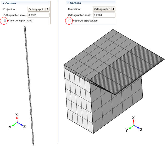

Another way to get around “Form Union” issue in your geometry is to use Work Plane Geometry and Extrude options, as shown in the attached mph file. For better visualization of your geometry, clear “Preserve aspect ratio” in the Camera View, as shown in the attached picture.
Please realize that extra care should be taken to build good quality mesh for this type of geometry.
Sergei
Sri, Another way to get around “Form Union” issue in your geometry is to use Work Plane Geometry and Extrude options, as shown in the attached mph file. For better visualization of your geometry, clear “Preserve aspect ratio” in the Camera View, as shown in the attached picture. Please realize that extra care should be taken to build good quality mesh for this type of geometry. Regards, Sergei

Sergei: My final geometry is a complex 3-D geometry which does not lend itself easily to extrusion. Just for these two elements, I tried extrusion and it worked. There were no errors. I have to now decide which of the two proposed solutions I will end up using.
