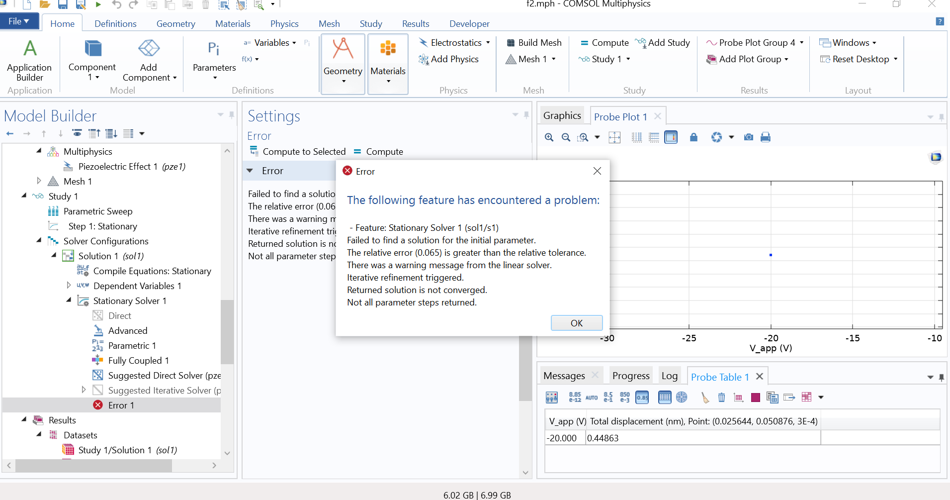

Hi COMSOL Friends, I am trying to find the generated displacement in the piezo materials upon the applied voltage in the inverse (indirect) piezoelectric effect. I am trying to find out the generated displacement in BaTiO3 piezo material upon application of 20 V. I have created a geometry of 5 x 5 mm^2, and the thickness is 250 nm. The simulated displacement is 0.44863 nm, but the hand calculation is ~ 0.82 nm (from the general formula, Displacement = d33. V). I don't know why this happens to me. I would be truly grateful for your kind help in this regard. I am attaching the COMSOL snapshot file here. Request you pl have a look and help me. Is the thin film and bulk piezo materials affect separately on the displacement upon an application of voltage??

Your screenshot shows that your calculation has not converged, so I don't place particular stock in the comparison.
Often these calculations do not converge because rigid body motion has not been suppressed. Post the model so we can see.
