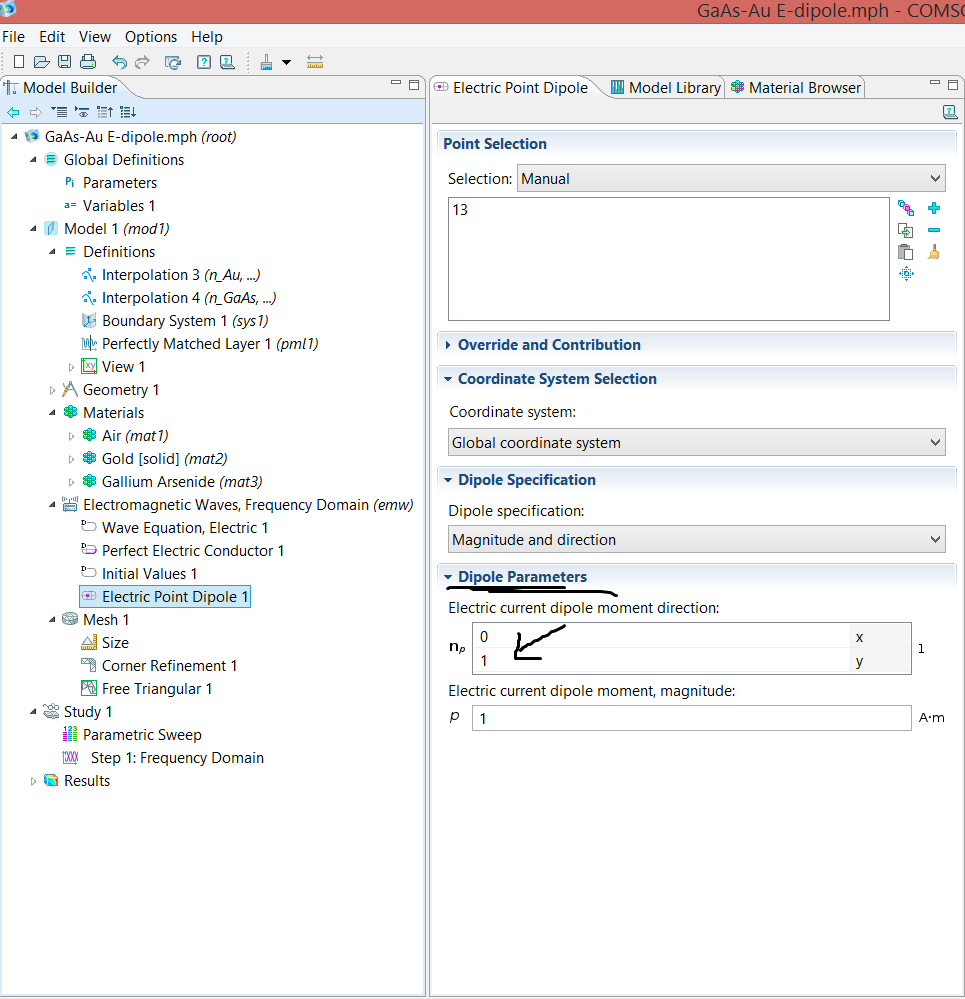

For Vertical and Horizontal Polarization, I chose Dipole : Magnitude and direction - x = 0 and y=1 for V-Pol and vice versa for H-Pol right ? Correct me if I m wrong.

Now, back to the dipole. Yes, you can control the polarization in the manner in which you state. You could even place multiple dipoles of various magnitudes and directions on top of each other to simulate coherent, unpolarized emission (I think there is a laborious way to do incoherent emission). However, the question remains as to what kind of data you would like to retrieve. You mention "finding electric field with Point source will be easy using COMSOL"--you are correct, it is! Just place the boundary/point probe where you want to sample (average, integrate, etc.) the field generated (and scattered) from the point source. But so what? Is the full-field output all the information you need? You will not get a transmittance that way! You won't even isolate the scattered field that way. So what is it you WANT to get out of the simulation?

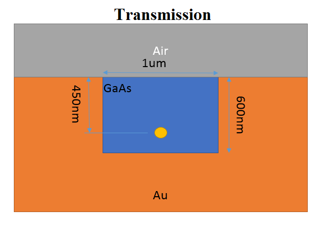

With Polarization(Horizontal mainly) in Dipole source, I want to find suitable position for Dipole (Point source between Au and Point source (QD). SO with this simulation, I m going to check the node and anti-node with respect to each target wavelength. For each target wavelength, I need either node/anti-node with respect to QD position. (for idea i just attached a picture). So based on QD position the desired target is achieved.

Ah, yes--I think I see what you are trying to do, now.
Keep in mind SBC will get you results of just the dipole radiation, since all the scattering inside the cavity will be suppressed (as will the portion of the dipole radiation that is parallel to the boundary--but at this proximity, that should be negligible). This seems to be what you want. Do you care about what the true (full) field will be? If so, then use the IBC. Certainly the results will be vastly different for the IBC compared to the SBC, because of the inclusion of the high scattering effects.
