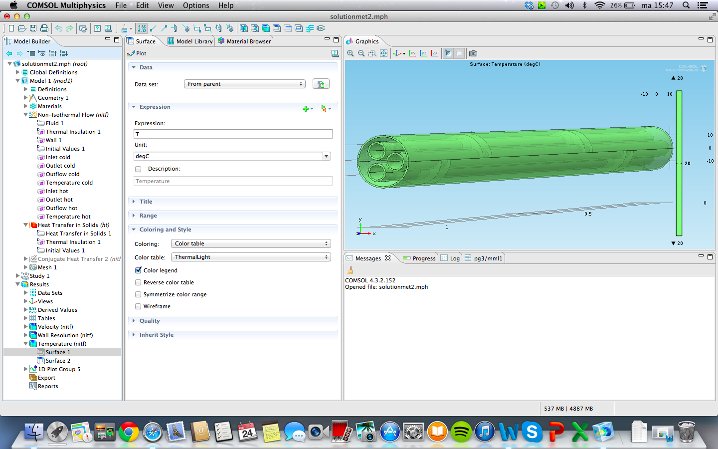

My model of a shell and tube heat exchanger has a constant temperature-profile.
It's possible that steady state inside the model is reached and overall temperature difference is made.
But this is not what I wanted of course.
How to solve this?
Thanks,
Adriaan De Bolle

Fluid is flowing through 3 tubes and over it. There should be heat transfer though the fluid and solid tubewalls.
Everything stays at constant beginning temperature.

Dear Adriaan,
You are solving two heat transfer interfaces, nitf and ht. The first computes the temperature "T", the second "T2". These have no influence on eachother when they are not manually coupled.
The easiest solution is to remove the heat transfer in solids interface, and add a "heat transfer in solids" node in the non-isothermal flow interface. This makes sure that all is computed in one interface.

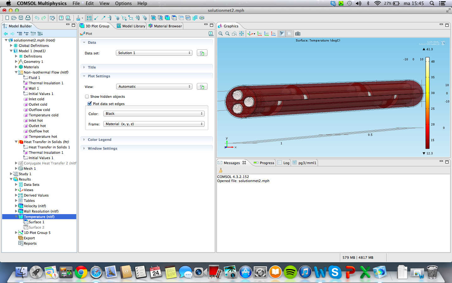

Hello Frank,
Thanks for tip! I tried it before, but I think my problem then was that I just updated the solution and didn't re-solve it. With the all-in-one module "conjugate" I already got better results.

I updated the model with correct computing of results.
How can I determine the "normal" Reynolds number for my case?
Comsol gives the cell reynolds number depending on the mesh element size. This gives values much lower than theoretical Reynolds values.
In fact the heat flux looks also too small: nitf2.ntflux.
Thanks everyone (also for previous problem)
I updated the model with correct computing of results. How can I determine the "normal" Reynolds number for my case? Comsol gives the cell reynolds number depending on the mesh element size. This gives values much lower than theoretical Reynolds values. In fact the heat flux looks also too small: nitf2.ntflux. Thanks everyone (also for previous problem)
