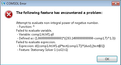

error, failed to evaluate expression, about the expression of the mathmatic
Posted 2014年2月26日 GMT+8 11:45 Heat Transfer & Phase Change, Parameters, Variables, & Functions Version 4.4 0 Replies
i am doing something about induction heating in 3D. In the node Heat flux i gave the "General in ward heat flux" q0 a equation: 1.86*(293.15-T)^1.3
But the Simulation returned a error Information(see the attached picture)
can someone tell me, how can i fix it? i had used this equation in 2D, it could work very well
thank you very much!
